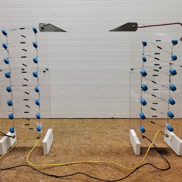

This project showcases a Cockcroft-Walton voltage multiplier, a clever setup using diodes and capacitors to step up voltage. The capacitors charge and discharge in an alternating pattern, doubling the voltage after each diode pair. [Mircemk] uses 3 mm thick Plexiglas as an insulator, providing both structure and electrical isolation for the diode-capacitor cascade.
To achieve the 330,000 V output, [Mircemk] starts by modifying a standard PC ATX power supply, removing the Schottky diodes from the secondary winding’s output to produce a roughly 15 V square wave. This feeds into another transformer, boosting the voltage before it enters the Cockcroft-Walton multiplier. At first glance, the multiplier’s sides look identical, but their opposite polarities create a massive potential difference across the spark gap.

    Second, it occurred to me that the multiplier implementation here lends itself well for insertion into a pair of vertical “tanks” fabbed from 4-in PVC pipe/pipe-caps or similar. Said tanks could then be filled with mineral oil, providing both cooling and self-healing insulation for the multiplier stack. One wonders how many stages could be added (just make the tanks taller) before other circuit factors result in diminished returns.
    Third, I wonder what the -power- output of this project might be. Is it feasible, for example, to use this basic architecture to develop, say, 3500 V at 0.5 amps for an HF linear amp? Clearly the flyback and PC supply wouldn’t be up to that task, but I’m interested in the academic prospect of eliminating a heavy and expensive plate transformer.
    Phrasing that thought another way, why don’t microwave ovens use a switched HV supply? Is the issue technical or one of simple economics, i.e., a transformer is the cheapest design option?
    1. I suspect that by using a transformer you get a free current limiter by virtue its inductance. That would be my guess, but I’m no expert.
      1. The current limiter comes for free because of saturation of the core (or resistance of the windings), not by its inductance. It’s a transformer, not a choke. In practice you’ll just get a very hot core or windings if you short it.
    2. First off, the cascade doesn’t double the voltage on each stage, but each stage adds the feeding voltage to the output.
      Main drawback is that the capacitors of the lower stages have to carry the loading current of all following stages, so in a 10 stage cascade for 3500 V at 0.5 A each (except the lowest) capacitor would see 700 V, and the lowest stage would pump 5 A through its capacitor. To keep the voltage drop reasonably low you would probably sell one of these capacitors, buy a 3.5 kV transformer and have a nice day for the rest of the money.
      1. I do not understand. All the sections are in series, so they carry the same current. How can the current in the first stage be 10x bigger then in the last stage? Where does the rest of the current go to?
        (I count 16 stages, but that’s a minor detail).
    3. Multipliers typically start with a transformer. This one feeds 15V pulses into a transformer to get a high AC that is then converted to a higher DC voltage.
      Given the number of multiplier stages, I suspect this one already has more stages than are really useful.
      The impedance of such multipliers goes up with the cube of the number of stages.
      This greatly limits the numberbof stages you can use and the power you can get out of the multiplier.
    4. A C-W multiplier is horribly inefficient: Charging capacitors from a real impedance is intrinsically lossy: just as much energy is lost in the charging circuit as is stored in the capacitor.
      It’s especially bad when designed improperly, like this one. As Mathias points out, the first of n stages must carry the current for the entire stack, or n times the output current, the second one, is (n-1) times, etc. The capacitors should be sized accordingly (bigger ones at the input side), or the actual output impedance will be very high, and current very low.
      A C-W supply for a microwave oven is just (from an engineering perspective) a really dumb idea. 2-4 kV from a transformer is trivial in comparison.
      If you want to save a bit of weight, don’t run your transformer at 50 or 60 Hz. Use 50 or 60 kHz, so you get to use a relatively tiny and light ferrite transformer core, like modern inverter-type appliances do.
      1. 50 or 60khz would be very lossy. Cap’s ESR would have to be very low (NPO caps would be better) a the junction capacitance of the diodes would have to be low (5 or 6pf or lower) or switching freq would cause diodes to heat up very rapidly…
        1. Of course you’re correct, and anybody capable of properly engineering such a thing would know these things. High speed high voltage diodes are not quite jellybeans, but readily available, and high-Q caps are not hard to come by. NP0 not necessarily needed. I have a 50 kV 2 kW supply that runs at 2 kHz, but only because it’s 40 years old and still uses bipolar drivers.
