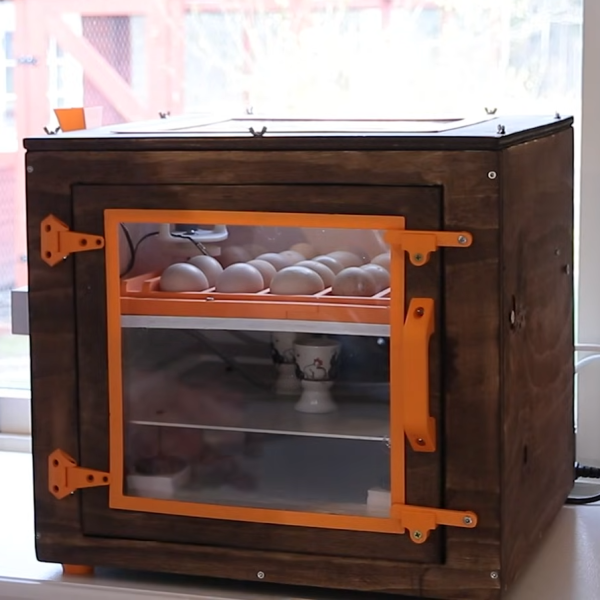

If you want to keep eggs warm to hatch, you’ll need an incubator. You could buy one off the shelf, but they’re not so complex — just a nicely-controlled warm box you could easily whip up yourself. As it turns out, that’s precisely what [RCLifeOn] did.
The incubator is built out of wooden panels screwed together to make a simple box. The frame of the front door is also wood, but it features 3D printed hinges and handles, because that’s the easiest way to make hardware when you’re a printing wizard like [RCLifeOn].
The box is fitted with controls for humidity and temperature to ensure the best possible conditions for hatching chicken eggs inside. As you might have guessed, a heated bed from a 3D printer was used to control the temperature inside. As for humidity, a sensor tracks the conditions in the box, and triggers an ultrasonic mister to increase the level as necessary. There’s also a little motion introduced via a moving platform run by a motor and some step-down gearing, which apparently aids in the hatching process.

  5. Even though it is fun and cool to see people who normally would not get chickens or farm animals I’ll be the negative person here. And it is not even about the animals, it is about over complicating everything. This should be nothing more than a heated PID controlled environment and the rest should be done manually IMHO. The automatic rotation of the eggs is a horrible idea and the amount of just garbage that he did that is involved is beyond stupid. I enjoy his channel but this build was horrible. He did nothing new except introduce new ways to make sure your eggs fail at hatching.
    Again I am all for people having chickens and other animals it teaches a lot.
    1. Would you care to elaborate on why the auto turners are a bad idea? They’re pretty standard afaik and it beats having to remember to turn them imo
      1. Auto turners done correctly do work well. Home DIY ones like this tend to kill lots of chicks when they are trying to hatch. Baby chicks are tough little suckers but can also be killed by the most fragile of things too sadly :(
    2. Meanwhile we did this in the ’90s with… an incandescent light bulb.. and prevented overheating via ventilation holes providing passive cooling..
