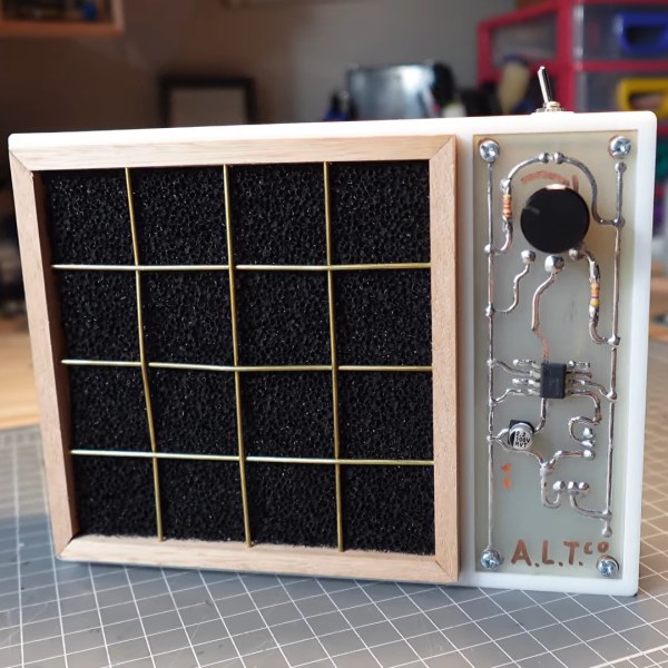

Nearly all modern PCBs are designed with the help of EDA software, but not all of them. [ALTco] shows us the process of plotting out a board the old-fashioned way — by hand.
Back in the day, drawing out the traces on a PCB lead to beautiful, smooth lines that [ALTco] wanted to imitate. But first, he needed to figure out how the rest of the fabrication process worked. He starts by just experimenting, both with the “resist” markers and paint, and the etching compound. Things rarely work first-try, and neither did his home-made etchant. So then it was time to buy some ferric chloride, the standard copper etchant for PBCs. A few more tests sorted out which permanent marker worked best.
[ALTco] starts by thoroughly cleaning a raw copper-clad board so the marker sticks properly, then draws the circuit for a little analog fan controller. The board is then laid in a bath of the etchant for several minutes while gently rocking it to keep the reaction going. Finally the board is taken out, etchant stored for re-use, and the board washed with water and then presumably IPA to remove the remaining marker. Some assembly of the newly-printed circuit board later and you have a cute little smoke absorber for your soldering projects.

From an electrical point of view these traditional PCBs are sometimes better, even.
The hand-drawn curves used for traces have less reflection than perfectly geometric ones generated by circuit design software.
You can do curved / rounded traces with Kicad using the round traces plugin.

I bought a handmade guitar pedal to fix and resell. I opened it up to start fixing and the handmade pcb is so beautiful I don’t think I want to sell it anymore. I just want to hang it on the wall with the back cover removed and look at it. Who care if it works. It’s art!
