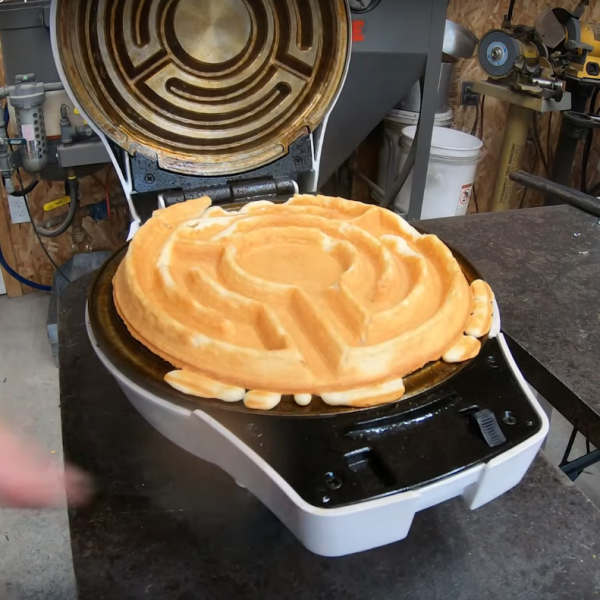

Everyone knows what its like to get a hankering for a specific food. In [Attoparsec]’s case, he wanted waffles. Not any waffles would do, though; he needed waffles in the form of a labyrinth. Those don’t exist, so he had to machine his own waffle maker.
Most of us would have run this off on a CNC, but [Attoparsec] isn’t into CNCing–manual machining is his hobby, and he’s not interested in getting into another one, no matter how much more productive he admits it might make him. We can respect that. After a bit of brain sweat thinking of different ways to cut out the labyrinth shape, he has the opportunity to pick up an antique Deckle pantograph mill.
These machines were what shops used to do CNC before the ‘computer numeric’ part was a thing. By tracing out a template (which [Attoparsec] 3D prints, so he’s obviously no Luddite) complex shapes can be milled with ease. Complex shapes like a labyrnthine wafflemaker. Check out the full video below; it’s full of all sorts of interesting details about the machining process and the tools involved.
If you don’t need to machine cast iron, but are interested in the techniques seen here, a wooden pantorouter might be more your speed than a one-tonne antique. If you have a hankering for waffles but would rather use CNC, check out these design tips to help you get started. If pancakes are more your style, why not print them?

I’ve spent an inordinate amount of time in FreeCAD to design my own CNC router (I drew at least 6 different machines before deciding on which configuration I’m going to finally build, and still tweaking details for the final version), but still I sort of like these old pantograph mills. They also seem to be in fashion lately. I saw one from Inheritance machining, then from that mythbuster guy, and now from attoparsec. Or, I now realize it started with the pantograph router from Matthias Wandel, which has also been commercialized into an aluminimum version.
As Attoparsec mentions at the end of this video, there is a bit of a learning curve. For example @10:05 he explains inner corners always have a radius of the size of the mill, and that’s true, but later on he uses a conical mill, and that has a quite small tip radius. If he had printed his template with sharp corners, he could have run his conical stylus up in the corners and created quite sharp inner corners in the cast iron. This is also what CNC software such as V-carve does, and in due time I think FreeCAD’s path workbench will also learn to do this.
I was surprised at the size of the engraving letter templates he bought (@ 08:38) and he soon discovered only a few fit on his machine. Not much luck for words of more then a handful of letters. I recommend he uses this templates to make new letters at 1/3 to 1/5 the size.
I also recommend that anyone using (or interested in) this type of machine watches the Matthias Wandel (Woodgears) video’s. He uses some nice tricks such as the length of extension of a conical guide pin to make cuts with a specific width, and to control the final width of cut precisely.

While it was acknowledged in the video, it’s good to reiterate the hobby of metal working on manual machines is quite a bit different from using a CNC machine or ordering the parts from a factory. I like the compromise the author found. Where you still get quite accurate parts, but get to do the machining yourself.
I don’t have experience with CNC myself, but see that you need quite a big and expensive machine to be reliable enough to do the work without babysitting. As where a 3D printer is a common and reliable tool, these days. I have to say, manual machining with 3D printed fixtures seem to work quite well.
