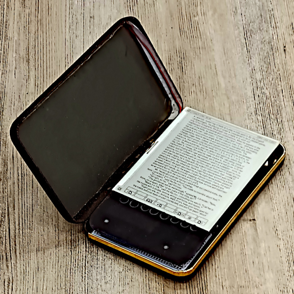

E-readers are an awesome creation allowing you to display digital information in a way that requires little battery life. While there’s plenty of very impressive models to chose from on the commercial market, it’s also possible to build one yourself — which is exactly what [kaos-69] did in his Mimisbrunnur project, creating a truly unique e-reader from scratch.
While looking through old junk at home, [kaos-69] came across a case that held a calculator and pen at one point in the distant past. The pen was gone and the calculator no longer functioned but the case held promise. He removed the calculator and got some parts on order. For the e-paper display he went with a 5.83-inch unit that just fit inside the spring-loaded case. The Mimisbrunnur is powered by a 2000 mAh LiPo battery, with a micro SD card reader for storing what will be displayed. The brains come from an RP2040 microcontroller on an Adafruit Feather breakout board, which worked out great as it already takes care of battery management and the 24-pin interface for the e-paper display.
There are also eight buttons that live below the display for user interface, and even some LEDs to aid in reading in the dark. The depth of the case allowed all this to be connected with the use of a perfboard and some risers to set the screen forward, allowing the battery to live behind it. Using the Mimisbrunnur is pretty straightforward with the eight buttons sitting below icons on the screen giving you clear guidance on how to turn the page, add a bookmark, or browse the SD card for another file to open.

  1. I used to save cases like that with the intention to put devices like this into them. Finally acknowledged years ago they were taking up more space than they were worth, and I would never in my remaining time use them. So with a bit of regret I binned the lot. Doesn’t diminish the good work done here though. Kudos.
    I am a bit worried about the corner of that display though, hanging out in harm’s way like that.
    1. “I am a bit worried about the corner of that display though, hanging out in harm’s way like that.”
      Yes, When cutting the base plate I made the mistake of rounding the corners too roughly match the shape of the case, only to find later that I needed to place the display at the very edge. If I revisit the mechanical side of the project, which I might, I will rectify that mistake. How does the old proverb go, “do as I say, don’t do as I do” :-)
