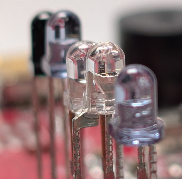

Ever wondered what happens when you insert a bill into a vending machine? [Janne] is back with his latest project: reverse engineering a banknote validator. Curious about how these common devices work, he searched for information but found few resources explaining their operation.
To learn more, [Janne] explored the security features that protect banknotes from counterfeiting. These can include microprinting, UV and IR inks, holograms, color-shifting coatings, watermarks, magnetic stripes, and specialty paper. These features not only deter fraud but also enable validators to quickly verify a bill’s authenticity.
[Janne] purchased several banknote validators to disassemble and compare. Despite varied exteriors, their core mechanisms were similar: systems to move the bill smoothly, a tape head to detect magnetic ink or security strips, and optical sensors to inspect visible, UV, and IR features. By reverse engineering the firmware of two devices, he uncovered their inner workings. There is a calibration procedure they use to normalize their readings, then it will analyze a bill through a sophisticated signal processing pipeline. If the data falls within a narrow acceptance range, the device authenticates the bill; otherwise, it rejects it.
