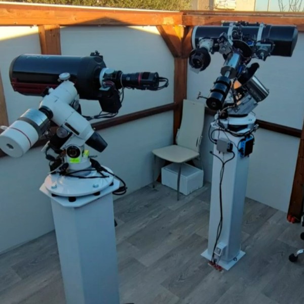

Here’s one for our astronomy geeks. Our hacker [arrow] has made their own observatory!
This particular video is a bit over ten minutes long and is basically a montage; there is no narration or explanation given, but you can watch clear progress being made and the ultimate success of the backyard facility.
Obviously the coolest thing about this building is that the roof can be moved, but those telescope mounts look pretty sexy too. About halfway through the video the concrete slab that was supporting one metal mounting pole gets torn up so that two replacements can be installed, thereby doubling the capacity of the observatory from one telescope to two.

      The focal lengths of the telescopes do not look that high – does this really need isolated concrete slabs? Insulated shed when you open up at night anyway and need cooldown? (active ventation is useful I guess) Looks like this way built in a backyard neighborhood – with random neighbors I expect a lot of stray light.
      A larger “hobby” telescope (600mm mirror, 6m focal length) I visited last year was a little outside the settlement, almost hidden behind a row of trees. Sure – concrete all-around but the dome was not even insulated as temperatures at night changes anyway.
      But hey – armchair complaints. I’d love to see what they do with it.
    2. This is BY FAR the easiest and cheapest way to do this.
      You need:
      stable mounting that doesn’t get moved.
      an “indoor space” for protecting the telescopes most of the time.
      an unobstructed view of the sky when using them
      ideally a stable temperature
      Combine those requirements and you get a shed with a concrete floor, permanent mounts, and a sliding roof.
      The roof needs to be strong enough to hold snow/ice if you live where they happen.
      It must shed water off the outer edges, with no inner seams.
      That means it is easiest to roll the whole roof away.
      The telescope s and supporting computers, cameras, CCD sensors, and the rest likely cost $50k-$100k.
      Building a $10k shed is cheap.
  3. Notice that the concrete holding the pier is isolated from the rest of the floor, to minimize transfer of vibration from walking around.
