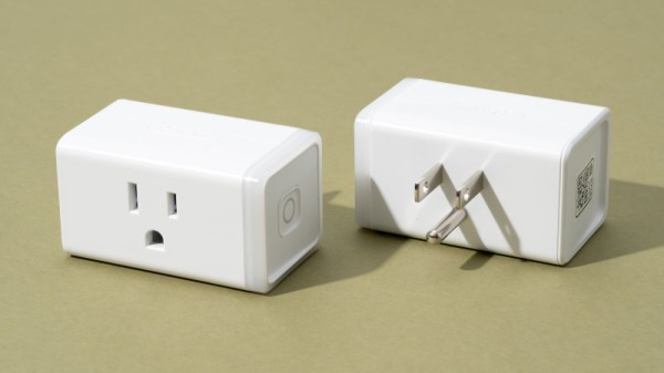

A Cheap Smart Plug To Block Distractions
We have all suffered from this; the boss wants you to compile a report on the number of paper clips and you’re crawling up the wall with boredom, so naturally your mind strays to other things. You check social media, or maybe the news, and before you know it a while has been wasted. [Neil Chen] came up with a solution, to configure a cheap smart plug with a script to block his diversions of choice.
The idea is simple enough, the plug is in an outlet that requires getting up and walking a distance to access, so to flip that switch you’ve really got to want to do it. Behind it lives a Python script that can be found in a Git Hub repository, and that’s it! We like it for its simplicity and ingenuity, though we’d implore any of you to avoid using it to block Hackaday. Some sites are simply too important to avoid!
