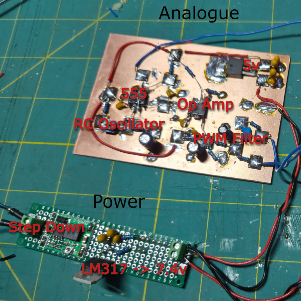

This entry by [burble] shows us how the humble 555 can hold its own in more demanding systems with some help from a GPS receiver. He used the One Pulse per Second (1PPS) output from a GPS module to discipline the 1 Hz output from a 555 by modulating the control voltage with a microcontroller.
Okay, this sounds a bit like baking a cake by buying a cake, scraping all the icing off, then icing it yourself, but what better way to learn how to ice a cake? The GPS-disciplined 555 is way more accurate than a free running one — just check out that Allan Deviation plot. While the accuracy of the standard 555 begins to decrease as oscillator drift dominates, the GPS-disciplined version just keeps getting better (up to a point — it would also eventually begin to increase, if the data were recorded for long enough). Compared to other high-end oscillators though, [burble] describes the project’s accuracy in one word: “Badly.”

    1. How is that analog circuit board made? How are the pads constructed?
      I know this is an old post…. But you start with blank copper-clad PCB. Pads are isolated from the rest of the copper by cutting around them with a sharp knife or scriber. Lots of flux used to solder to the pads. If you need a search term, it’s sometimes called “manhattan construction”
