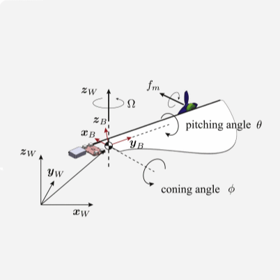

We’ve seen aircraft based on “helicopter” seeds (technically samara seeds, which include those of maples and elms) before, but this recent design from researchers at the Singapore University of Technology and Design (SUTD) shows how a single small motor can power a spinning monocopter capable of active directed flight, including hovering.
The monocopter is essentially an optimized wing shape with a single motor and propeller at one end. Hardware-wise it might be simple, but the tradeoff is higher complexity in other areas. Physical layout and balance are critical to performance, and software-wise controlling what is basically a wing spinning itself at high speed is a complex task. The payoff is highly-efficient flight in a package that self-stabilizes; it weighs only 32 grams and has a flight time of 26 minutes, which is very impressive for a self-contained micro aircraft.
