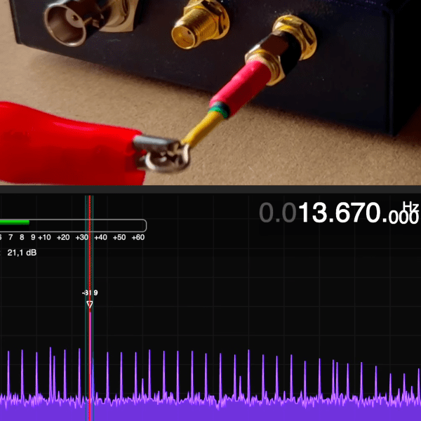

If you are casually listening to the radio, you probably tune into a local station and with modern receivers and FM modulation, the sound quality is good. But if you are trying to listen to distant or low-powered station, there’s a lot of competition. Our modern world is awash in a soup of electronic interference. [Electronics Unmessed] tells — and shows — us how much noise can show up on a SDR setup and what simple things you can do to improve it, sometimes tremendously.
According to the video, the main culprit in these cases is the RF ground path. If you have a single antenna wire, there still has to be a ground path somewhere and that may be through the power line or through, for example, a USB cable, the host computer, and its power supply. Unsurprisingly, the computer is full of RF noise which then gets into your receiver.
Adding a counterpoise makes a marked difference. A low inductance ground connection can also help. The counterpoise, of course, won’t be perfect, so to further turn down the noise, ferrite cores go around wires to block them from being ground paths for RF.
The common cores you see are encased in plastic and allow you to snap them on. However, using a bare core and winding through it multiple times can provide better results. Again, thanks to the SDR’s display, you can see the difference this makes in his setup.
None of this is new information, of course. But the explanation is clear, and being able to see the results in a spectrum display is quite enlightening. Those cores essentially turn your wire into a choke. People think that grounding is simple, but it is anything but.

    1. The counterpoise still exists even if you use an EFHW . If you omit a physical counterpoise line(s) , it still exists as your outer surface of your coax feed line. This gets back to your receiver. It is known as the i3 current. Now no harm done if this RF current doesn’t bite you when you transmit. But, consider how much local noise you are now picking up from indoor appliances, wall warts,etc (see Bill’s comments, above).
      Does this really happen? Several of our local hams constructed EFHW ‘s with 49:1 XFORMERs . Counterpoise connected, noise dropped audibly.
    2. It’s hard to tell from your post and hopefully it’s a joke, but if you actually think an end fed antenna doesn’t need a counterpoise you are seriously mistaken. If you don’t provide a counterpoise the feedline will become one and cause all sorts of problems, particularly unwanted noise pickup. An end fed antenna without a good additional counterpoise is one of the very worst configurations possible … for either transmit or receive. And even with a good counterpoise a feedline choke is needed in addition because of imbalance.
