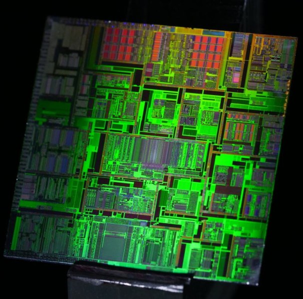

Die shots of an Intel Itanium processor courtesy of [der8auer].
