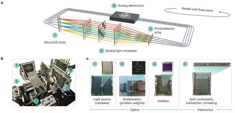

Although computers are overwhelmingly digital today, there’s a good point to be made that analog computers are the more efficient approach for specific applications. The authors behind a recent paper in Nature are arguing that inference – essential for LLMs – can be done significantly more efficiently using an analog optical computer (AOC).
As the authors describe it, the function of this AOC is to perform a fixed-point search using only optical and analog electronic components. The optics handle the matrix-vector multiplications, while the analog components handle the non-linear operations, subtractions and annealing. This is performed in 20 ns cycles until noise has been reduced to an acceptable level, considering the analog nature of the computer. A big advantage here is that no analog-digital conversions are required as with other (digital) hybrid systems.
So far a small-scale AOC has been constructed for tasks like image classification and non-linear regression tasks, with the authors claiming the AOC being over a hundred times more efficient than current GPU-derived vector processors.
If I understand correctly, it’s basically a row of LEDs, the light projected into lines onto grayscale TFT, and gathered again into points on photodetector in the perpendicular direction. Fairly simple tech actually.
But I have to wonder, wouldn’t it be a lot more efficient to replace it all with transistors, and stay in the electronic domain? The TFT acts as a not-very-precise multiplier, which can be done by controlling FET gate voltage, and the optics just take an average, which can be done with resistors. If you get fancy with CCDs, the computation can be kept in analog domain through multiple matrix operations.
Optics could theoretically have some speed advantage, but you still need electronics to drive the LEDs and to gather the output. The real bottleneck would probably be update speed of the TFT (assuming you don’t dedicate one computational unit to one set of matrix values).
It’s not that pure analog electronics aren’t possible, they are. But optics helps push the scaling further, reduces some of the electrical overhead (wiring, parasitics, datapath), and enables operations that would be less efficient (or nearly impossible) in purely electronic analog hardware at large size.
Optics + analog electronics give a better “sweet spot” for doing large, dense, linear operations (matrix multiplication, etc) very efficiently in parallel.
