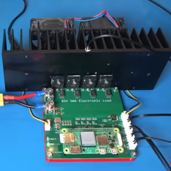

The main problem with the cheaper battery testers, at least for [LiamTronix]’s use cases, is that he has plenty of batteries that are too large to practically test on the low-current devices, or which have internal battery management systems (BMS) which can’t connect to these testers. The first circuit he built to help solve these issues is based on a shunt resistor, which lets a smaller IC chip monitor a much larger current by looking at voltage drop across a resistor with a small resistance value. The Pi uses a Python script which monitors the current draw over the course of the test and outputs the result on a handy graph.
This circuit worked well enough for smaller batteries, but for his larger batteries like the 72V one he built for his electric tractor, these methods could draw far too much power to be safe. So from there he built a much more robust circuit which uses four MOSFETs as part of four constant current sources to sink and measure the current from the battery. A Pi Zero monitors the voltage and current from the battery, and also turns on some fans pointed at the MOSFETs’ heat sink to keep them from overheating. The system can be configured to work for different batteries and different current draw rates, making it much more capable than anything off the shelf.

    1. No, the video said it can handle about 140 watts continuous.
      The IRFP4768 MOSFETs used are a bad choice for an electronic load. They are designed for switching, not for linear use. The safe operating area for DC is less than 20 volts at 1 amp.
  1. I was going to write and say a Pi Zero is overkill for this, but after watching the video, I see that it’s a good fit, since the goal is to make a system to easily experiment with, not to make into a single-purpose product.
    1. It is overkill indeed. There is no reason why this couldn’t have been a USB or RF controlled MCU driving the hardware. The Pi Zero only makes things easier, but its not required at all
