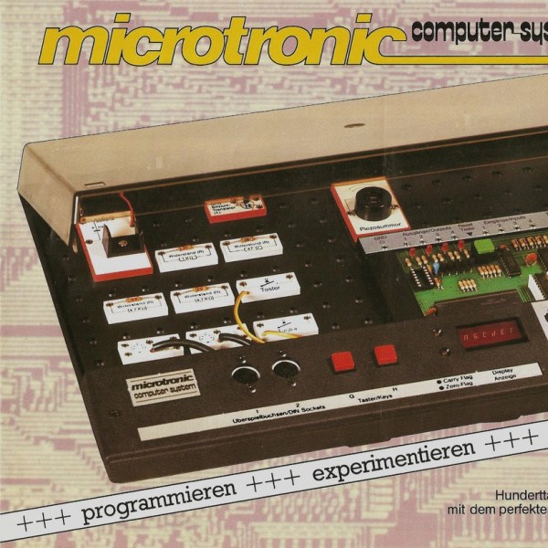

Photo of Microtronic 2090
A team of hackers, [Jason T. Jacques], [Decle], and [Michael A. Wessel], have collaborated to deliver the Microtronic Phoenix Computer System.
In 1981 the Busch 2090 Microtronic Computer System was released. It had a 4-bit Texas Instruments TMS1600 microcontroller, ran at 500 kHz, and had 576 bytes of RAM and 4,096 bytes of ROM. The Microtronic Phoenix computer system is a Microtronic emulator. It can run the original firmware from 1981.
