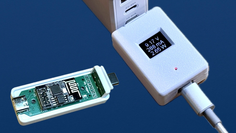

As USB-C PD becomes more and more common, it’s useful to have a tool that lets you understand exactly what it’s doing—no longer is it limited to just 5 V. This DIY USB-C PD tool, sent in by [ludwin], unlocks the ability to monitor voltage and current, either on a small screen built into the device or using Wi-Fi.

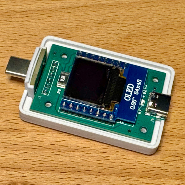

This design comes in two flavors: with and without screen. The OLED version is based on an STM32, and the small screen shows you the voltage, current, and wattage flowing through the device. The Wi-Fi PD logger version uses an ESP-01s to host a small website that shows you those same values, but with the additional feature of being able to log that data over time and export a CSV file with all the collected data, which can be useful when characterizing the power draw of your project over time.
Both versions use the classic INA219 in conjunction with a 50 mΩ shunt resistor, allowing for readings in the 1 mA range. The enclosure is 3D-printed, and the files for it, as well as all the electronics and firmware, are available over on the GitHub page. Thanks [ludwin] for sending in this awesome little tool that can help show the performance of your USB-C PD project. Be sure to check out some of the other USB-C PD projects we’ve featured.

But there is nothing USB-PD here, it’s just a voltage/current monitor that has Type-C plugs on both ends
Came back to make exactly this comment… it’s a voltage and current meter with USB-C connectors. Nice, but it has a misleading name.
Moreover, you can buy real USB-PD tools in smaller form factor that actually decode the PD protocol on the CC lines to show additional data.
And, if you plug this in an EPS-capable USB-PD power source, it might even fry the circuit due to going higher than 24V.
