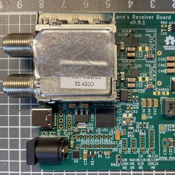

Generally, a digital TV tuner is something you buy rather than something you make yourself. However, [Johann] has always been quite passionate about the various DVB transmission standards, and decided he wanted to build his own receiver just for the fun of it.
[Johann]’s build is designed to tune in DVB-S2 signals transmitted from satellites, and deliver that video content over a USB connection. When beginning his build, he noted it was difficult to find DVB reception modules for sale as off-the-shelf commercial parts. With little to nothing publicly available, he instead purchased a “Formuler F1 Plug & Play DVB-S2 HDTV Sat Tuner” and gutted it for the Cosy TS2M08-HFF11 network interface module (NIM) inside. He then paired this with a Cypress CY7C68013A USB bridge to get the data out to a PC. [Johann] then whipped up a Linux kernel driver to work with the device.
[Johann] doesn’t have hardcore data on how his receiver performs, but he reports that it “works for me.” He uses it in South Germany to tune in the Astra 19.2E signal.

  3. I’m a little confused by the rationale of this project. The author writes “reception modules (NIMs, consisting of tuner and demodulator) are not publicly available for purchase” – this is not true.
    Although not popular, DVB-S2(X) receivers are available from TBS in various versions. While I share the sentiment of the author to do stuff himself, I don’t want other readers to think this is the only way.
    1. “NIM” only refers to the tin can at the top left, not to the whole board.
      If it makes sense is not a question I would raise for a hobby. For me personally, I now understand most aspects of DVB-S2 reception from the dish to the transport stream layer of the Linux kernel, and, along the way, I learned about the 8051 CPU. But, of course, you can also ask AI.
      1. I did eventually understand that the whole idea is to process the bitstream directly from NIM. Didn’t occur to me at first…
