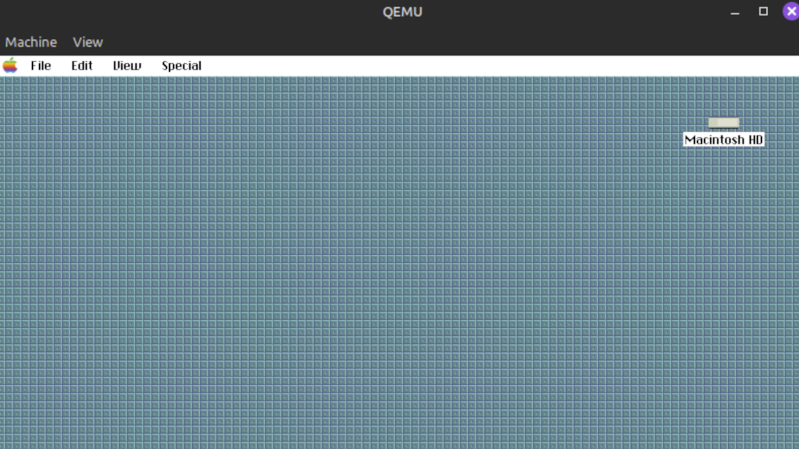

[Kelsi Davis] decided to port the Macintosh System 7 OS to run on native x86 hardware, which would be challenging enough with full access to the source code. However, she instead performed this task by analyzing and reverse engineering the System 7 binaries with the aid of Ghidra and a large language model. Soon enough, she had the classic System 7 desktop running on QEMU with a fully-functional Finder and the GUI working as expected. [Kelsi] credits the LLM with helping her achieve this feat in just three days, versus what she would expect to be a multi-year effort if working unassisted.
Files are on GitHub for the curious. We love a good port around these parts; we particularly enjoyed these efforts to recreate Portal on the N64. If you’re doing your own advanced tinkering with Macintosh software from yesteryear, don’t hesitate to let us know.

This is my project, just to clarify it is not fully functional it is a booting skeleton still needs lots of work, pull requests are open :D
additionally it’s not meant to just be an x86 port it’s portable and could run on any number of platforms.

This is fraudulent, at best. While at some level this project is an interesting commentary on what can be done with a LLM, to say it resulted solely from binary analysis as a clean-room is actively disingenuous (aka. a lie). There are literal references to the apple source files that originated the C sources in this project. These are not referenced in the whitepaper at all!
For example, see these files (there’s much more…). As of the current revision these files are still present and presumably used as-is.
https://github.com/Kelsidavis/System7/blob/5c38150d28422802a251ab35506edbd7d9aab4da/src/MemoryMgr/memory_manager_core.c
https://github.com/Kelsidavis/System7/blob/5c38150d28422802a251ab35506edbd7d9aab4da/src/QuickDraw/quickdraw_pictures.c
I don’t know how commonly it’s known outside the mac community, but the entire System 7.1 / “SuperMario” ROM source was leaked a few years ago and can be browsed in this repository: https://github.com/elliotnunn/supermario . As someone who is quite familiar with that source, it was obvious skimming through the project sources that there was more “understanding” than could be explained by any amount of time spent solely in debuggers and binary reverse engineering tools. Many common strings, method names, concepts, etc that you will /never/ recapture exactly through any amount of binary analysis.
Clearly, the entire apple source must have been fed into an LLM, along with indeterminate middle steps as we can’t trust methodology from the paper, the result being an “act-alike” sharing some concepts but no practical relation after manual cleanup/additional implementation to get something that can boot. The sad part is that alone would have been interesting without the fake premise, but to coaching this project as any kind of “reverse engineering by LLM” is fake until proven otherwise.
LLMs know stuff, they hold all of the knowledge compressed inside. Rather famously early LLMs would recite Carmac Fast inverse square root verbatim including header and comments. Thats what makes LLMs both useful and super sketchy legally.
You cited two files. I ran function/body clone detectors (CPD/NiCad) on those exact pairs and found no cross-repo clones. Our winnowing similarity is low and localized to public API/opcode names required by Inside Macintosh. Internals differ materially (heap metadata, compaction strategy, error/bounds handling, parser structure, logging).
We also scanned the repo for Apple/SCCS markers and “SuperMario” mentions — zero hits.
Detailed ROM→C derivations for these two files (with addresses/bytes) are in docs/DERIVATION_APPENDIX.md. I welcome third-party audits; reproducible builds and scripts are provided.
The introduction of docs/DERIVATION_APPENDIX.md very clearly post-dates the version of memory_manager_core.c linked by zigzagjoe. At that hash, the top of memory_manager_core.c indicates:
“* Reimplemented from Apple Computer Inc. source code:
* – MemoryMgrInternal.a (SHA256: 4a00757669c618159be69d8c73653d6a7b7a017043d2d65c300054db404bd0c9)”
MemoryMgrInternal.a never shipped with any public Apple SDK, yet that version of memory_manager_core.c references several symbols defined only in the SuperMario sources. Sorry, but replacing a file in your own repository clearly derived from Apple’s internal sources — and documented to be so in that same file — with a C rewrite does not constitute a “clean room” reimplementation nor does it absolve this project from training an LLM with copyrighted Apple code. At best, this is a misunderstanding of terminology; at worst, the provenance of this project (and your reply to zigzagjoe) is disingenuous indeed.
The original sources are all in 68k assembly. Disassembling the binary will result in the same instructions, and any C reimplementation is going to be fresh work.
The only thing you’ve found is that they had metadata about which source files various objects were originally in, which is something that is often available even when the sources themselves aren’t.

ARCHAEOLOGY.md has numerous references to chapter 2 of “IM:Windows Vol I”. However, there is no such volume of Inside Macintosh. There’s the original /Inside Macintosh, Volume I/ which introduces the Window Manager in chapter 9 (and whose page numbers are volume-, not chapter-relative), and the newer /Inside Macintosh: Macintosh Toolbox Essentials/, with the Window Manager as chapter 4. The latter volume does use chapter-relative page numbers; chapter 2 covers the Event Manager.
ARCHAEOLOGY.md contains this claim: “BeginUpdate sets port and clip to (visRgn ∩ updateRgn); EndUpdate validates updateRgn.” Two citations of IM:Windows Vol I are provided as evidence:
pp. 2-81 to 2-82: "BeginUpdate sets the port's clip region to the intersection of the visible and update regions"
While it’s true that drawing occuring between BeginUpdate() and EndUpdate() is clipped to the intersection of the visRgn and the updateRgn, that’s because BeginUpdate() alters the visRgn, not the clipRgn. This is documented in the Window Manager chapters of both old and new Inside Macintosh.
Incidentally, chapter 2 of IM: MTE does mention BeginUpdate() on page 2-48: “The BeginUpdate procedure temporarily replaces the visible region of the window’s graphics port … with the intersection of the visible region and update region of the window.” (emphasis mine)
p. 2-82: "EndUpdate validates the entire update region"
I’m not sure what meaning is intended here. IM: MTE p. 2-48 continues: “The BeginUpdate procedure then clears the update region of the window”. So by the time EndUpdate() is called, the update region is empty. If “validates” indicates a call to ValidRgn(), it’s a no-op because the region is empty. Otherwise, I have no idea how to parse that statement, and it doesn’t resemble anything I’ve seen elsewhere. Quoting IM: MTE p. 2-48 once more: “The EndUpdate procedure restores the normal visible region of the window’s graphics port.” In other words, EndUpdate() doesn’t do anything at all with the update region.
