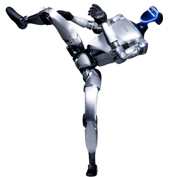

Unitree’s flagship G1 humanoid robot platform (one of the many models affected)
