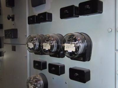

Although it wouldn’t be known until later, the root cause of what was then the largest power outage in world history began with equipment that was designed to protect the grid. Despite its continent-spanning scale and the gargantuan size of the generators, transformers, and switchgear that make it up, the grid is actually quite fragile, in part due to its wide geographic distribution, which exposes most of its components to the ravages of the elements. Without protection, a single lightning strike or windstorm could destroy vital pieces of infrastructure, some of it nearly irreplaceable in practical terms.
Protective relays like these at a hydroelectric plant started all the ruckus. Source: Wtshymanski at en.wikipedia, CC BY-SA 3.0
Tasked with this critical protective job are a series of relays. The term “relay” has a certain connotation among electronics hobbyists, one that can be misleading in discussions of power engineering. While we tend to think of relays as electromechanical devices that use electromagnets to make and break contacts to switch heavy loads, in the context of grid protection, relays are instead the instruments that detect a fault and send a control signal to switchgear, such as a circuit breaker.
Relays generally sense faults through a series of instrumentation transformers located at critical points in the system, usually directly within the substation or switchyard. These can either be current transformers, which measure the current in a toroidal coil wrapped around a conductor, much like a clamp meter, or voltage transformers, which use a high-voltage capacitor network as a divider to measure the voltage at the monitored point.
Relays can be configured to use the data from these sensors to detect an overcurrent fault on a transmission line; contacts within the relay would then send 125 VDC from the station’s battery bank to trip the massive circuit breakers out in the yard, opening the circuit. Other relays, such as induction disc relays, sense problems via the torque created on an aluminum disk by opposing sensing coils. They operate on the same principle as the old mechanical electrical meters did, except that under normal conditions, the force exerted by the coils is in balance, keeping the disk from rotating. When an overcurrent fault or a phase shift between the coils occurs, the disc rotates enough to close contacts, which sends the signal to trip the breakers.
The circuit breakers themselves are interesting, too. Turning off a circuit with perhaps 345,000 volts on it is no mean feat, and the circuit breakers that do the job must be engineered to safely handle the inevitable arc that occurs when the circuit is broken. They do this by isolating the contacts from the atmosphere, either by removing the air completely or by replacing the air with pressurized sulfur hexafluoride, a dense, inert gas that quenches arcs quickly. The breaker also has to draw the contacts apart as quickly as possible, to reduce the time during which they’re within breakdown distance. To do this, most transmission line breakers are pneumatically triggered, with the 125 VDC signal from the protective relays triggering a large-diameter dump valve to release pressurized air from a reservoir into a pneumatic cylinder, which operates the contacts via linkages.

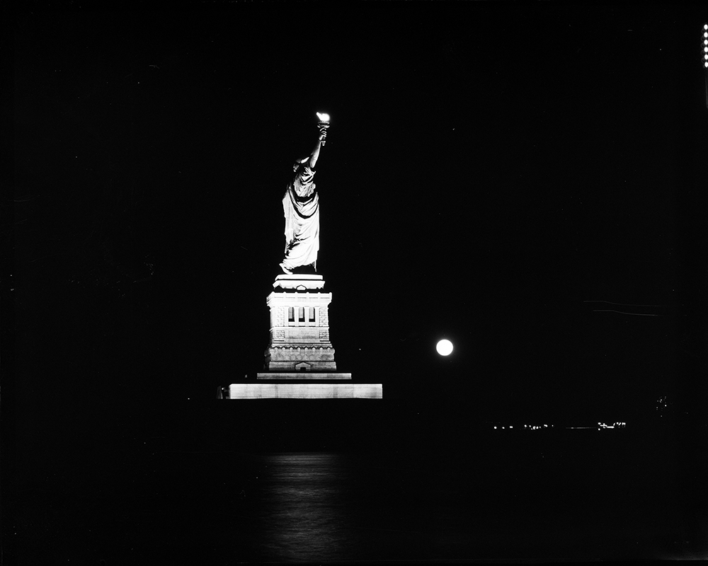

Liberty stands alone. Lighted from the Jersey side, Lady Liberty watches over a darkened Manhattan skyline on November 9. The full moon and clear skies would help with recovery. Source: Robert Yarnell Ritchie collection via DeGolyer Library, Southern Methodist University.
