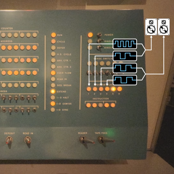

The video demonstration was recorded at the Computer History Museum in Mountain View, California. [Peter Samson] is operating the PDP-1, which is running the Harmony Compiler—which allows the machine to play four individual voices. This is achieved by taking advantage of the PDP-1’s program flags, which are visible as six light bulbs on the control panel. Instructions can be used to turn these bulbs on and off. The Harmony Compiler works by switching the bulbs on and off fast enough to create audible square waves when the light bulb outputs are wired to a simple audio amplifier.
