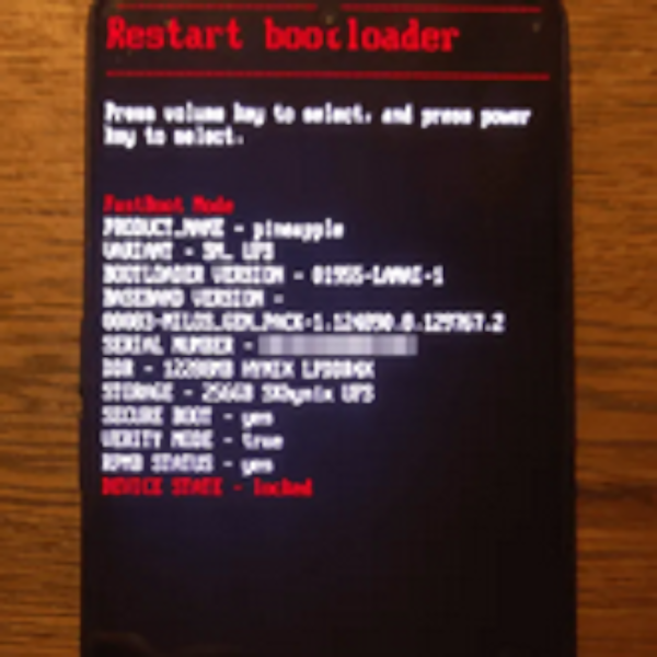

Interestingly, the target device for the tutorial is an Android phone in bootloader mode. We thought that was strange at first, until we read the rationale. You can easily get your hands on an Android phone if you don’t already have one. The device is simple. Plus, it is unlikely you already have drivers installed on your system that would interfere with your tutorial driver. Makes sense.
After that, it is pretty straightforward to use libusb to find the phone, determine what you can do with it, and communicate with it. Sure, the phone’s “fastboot” protocol is simple, but that’s just like using a TCP socket. You may implement a fancy protocol on top of it, but that doesn’t mean sockets are hard to use.
