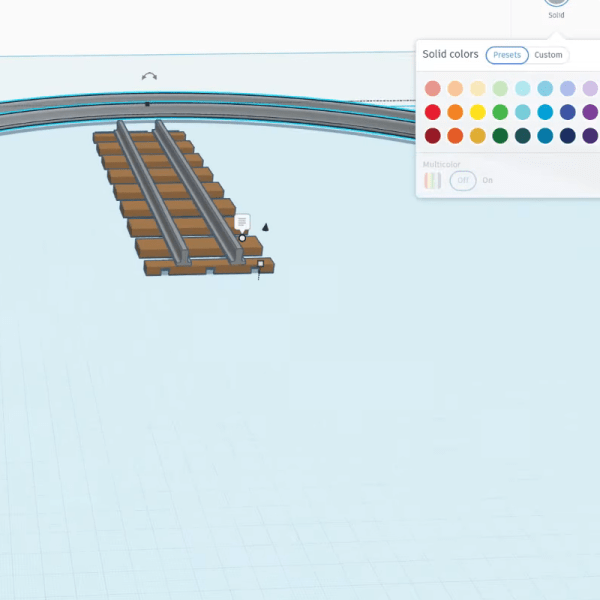

In the video, you can see how the revolve works. One nice feature is that in the top right corner is a live preview of what your shape will look like after revolving. The video shows a classic example — a chess piece. If you want to see something more practical, he also has a project to create train tracks using the new feature.
