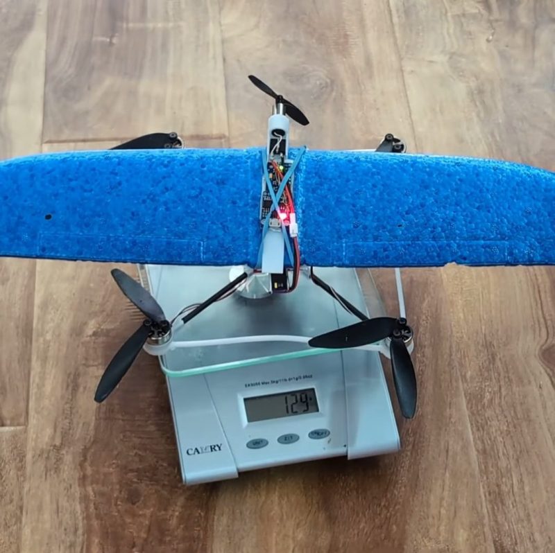

What if you want to get in on the eVTOL game but don’t have (or want) billionaire backing? Long-time contributor [spiritplumber] demonstrates how to do it on the cheap, with a low-cost quadcopter and a foam wing called Lift5.
Most eVTOL isn’t just quadcopters, after all — multirotors are great for playing with in the back yard, but their thrust-based lift makes for short range, and the engine-out options are all bad. Add a wing, and you can get that sweet, sweet dynamic lift. Add an extra, forward facing motor, and you can get thrust in the direction you need it most. That’s what [spiritplumber] is doing here: strapping a foam wing to a cheap quadcopter. Specifically, his custom frame for an Eiele F120 drone kit.You can see it in action in the demo video embedded below.
The wing and its forward thrust motor are equipped with its own speed controller, so the concept should be adaptable to just about any little drone. Quadcopter flight computers are mostly going to be able to compensate for the added lift and thrust automatically, which is neat, considering that these forces would require some bizarre headwind/updraft very unlikely to be found in nature.
Now the wing does add a lot of drag during the lift phase, to be sure, so [spiritplumber] is working on folding or tilting it out of the way, but that version is apparently inordinately fond of trees. Once the control issues are worked out you’ll likely see it on his site and YouTube channel Robots Everywhere.

  1. Good work. I built one using the same idea three years ago. Using the quad copter idea for evtol and the wing can extend the mileage coverage x3. Hope your work can move forward. Lots of wing designs to choose from.
  2. For me that video looks like the wing doesn’t really generate any lift. It doesn’t glide at all, just looks like normal quadcopter flying around.
    1. That’s kinda the point. You can tell that it works because it stays in the air longer when used to go back and forth :) this mess, while adding weight, adds about 1/3rd to flight time.
      The next version will have folding wings to hopefully do a little better than that.
    2. You’d have to be deliberately faking it by using the elevation controls for it to rise when it’s accelerating forward, deliberately reversing slowly, etc to get that effect. Also, observe the coordinated turns. It’s not generating enough lift on its own, but it is generating a meaningful amount.
      With my own experience designing model planes: the one with the white wing would probably fly without the quad rotors at all, if the horizontal motor was bigger. That’s a really tiny motor, it needs more thrust.
    3. We tested your theory with version 2 (which we’ll put on thingiverse next week) and it turns out that it can do a horizontal takeoff on low battery when there’s not enough juice to do a vertical takeoff. We filmed it, too!
  3. Not aerodynamically stable in forward flight.
