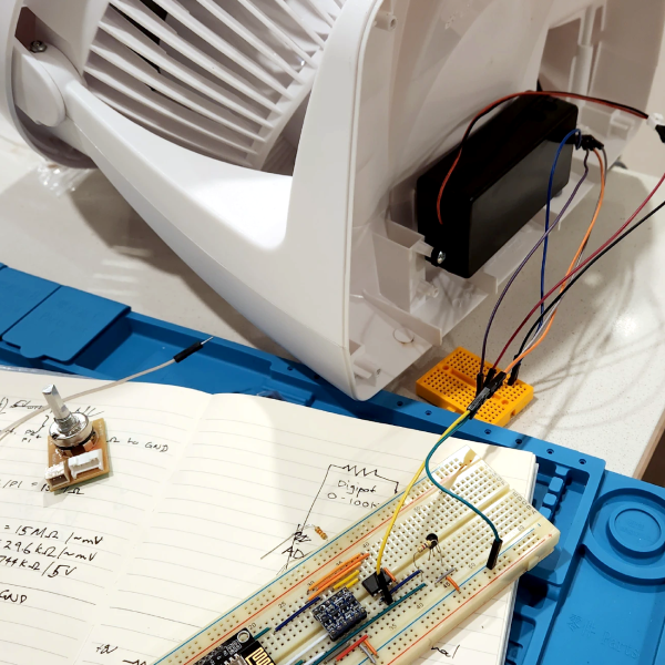

Given that we live in the proverbial glass house, we can’t throw stones at [ellis.codes] for modifying a perfectly fine Vornado fan. He’d picked that fan in the first place because, unlike most fans, it had a DC motor. Of course, DC motors are easier to control with a microcontroller, and next thing you know, it was sporting an ESP32 and a WiFi interface.
The original fan was surprisingly sparse inside. A power supply, of course, and just a tiny PCB for a speed control. Oddly, it looks like the speed control was just a potentiometer and a 24 V supply. It wasn’t clear if the “motor” had some circuitry in it to do PWM control or not. That seems likely, though.
Regardless, the project opted for a digital pot IC to maintain compatibility. One nice thing about the modification is that it replaces the existing board with the same connectors. So if you wanted to revert the fan to normal, you simply have to swap the boards back.
Now the fan talks to home automation software. Luckily, there’s still nothing wrong with it. We love seeing bespoke ESPHome projects. Even if your fan has WiFi, you might not like it communicating with Big Brother.

    1. Why would it fail like that? He made a new PCB and the digipot is running on 5V, the motor current isn’t going through it. Did you even read his writeup?
    2. It wont start a fire if you know what you are doing. But yes, there is the need to ask yourself the question, is this safe, can I make it safer, when doing modifications to equipment.
  3. Whats with all the negativity? It’s just a 24v fan. Does not seem to have a heating element or anything. He’s simply mimicking the speed control knob, and its done in a clever way.
