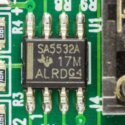

Kramer Electronics PT-102AN - board - Texas Instruments SA5532A
Texas Instruments SA5532A variant of the 5532 op-amp. (Credit: Raimond Spekking, Wikimedia)
Although the 5532 op-amps are multi-sourced, there are good reasons to just stick with manufacturers like TI, as that means receiving a product change notification (PCN) when anything changes. In the PCN related to this op-amp a change to process node is noted, along with other changes, but no reasoning.

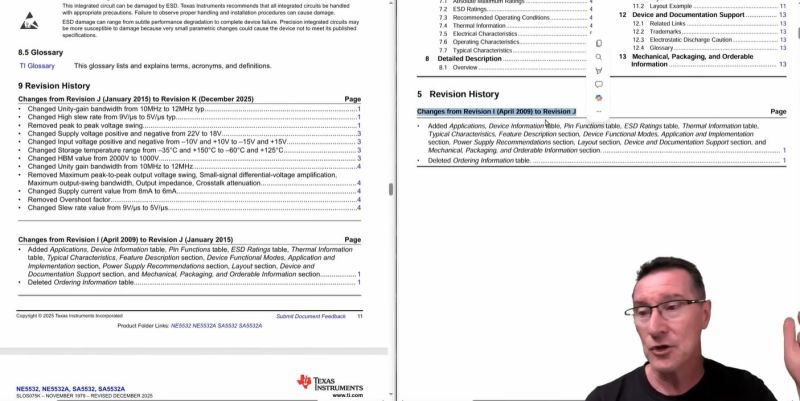

Among the other big changes are a reduction in the supply voltage from 22 V to 18 V, and a halving of the ESD protection from 2 kV to 1 kV. Although it might be slightly more efficient on the new process node this way, it clearly comes with a lot of trade-offs that make it an overall worse op-amp, while also being incompatible with the same op-amp from other manufacturers.
In the video [Dave] goes through the datasheets of this jellybean part of other manufacturers, showing that they still have the original 1980s specifications. Only one exception here was the NE5532DR from Shenzhen HuaXuanYang Electronics, whose supply rail voltage is also 18 V for some reason, along with a similar internal transistor configuration that reduces the ESD resistance.

      1. That document says nothing about about things like the reduced slew rate or 18V rails. In fact it indicates there is no change to the Data Sheet.
      2. Change Type: [bunch of stuff, notably not “Data Sheet”]
        Anticipated impact on Form, Fit, Function, Quality or Reliability (positive / negative):
        None
        A PCN doesn’t count when it’s blatant lies. And even if it did count, you don’t simply reuse a part number when it’s essentially a completely different part.
