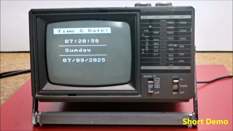

If you’ve got an old black and white TV, it’s probably not useful for much. There are precious few analog broadcasters left in the world and black and white isn’t that fun to watch, anyway. However, with a little work, you could repurpose that old tube as a clock, as [mircemk] demonstrates.
The build is based around an Arduino Nano R3. This isn’t a particularly powerful microcontroller board, but it’s good enough to run the classic TVOut library. This library lets you generate composite video on an Atmel AVR microcontroller with an absolute minimum of supporting circuitry. [mircemk] paired the Arduino with a DS3231 real-time clock, and whipped up code to display the time and date on the composite video output. He then also demonstrates how to hack the signal into an old TV that doesn’t have a specific input for composite signals.
You’ll note the headline says “any old TV can be a clock,” and that’s for good reason. Newer TVs tend to eschew the classic composite video input, so the TVOut library won’t be any good if you’re trying to get a display up on your modern-era flatscreen. In any case, we’ve seen the TVOut library put to good use before, too. Video after the break.

  1. Fun fact: You don’t need to hack your TV for VBS input, you can also use an external RF modulator (aka VHF/UHF modulator).
    The positive side is better galvanic insulation,
    because historically the antenna jack has a capacitor on the input and there’s no direct electric connection (RF only).
    The negative side is more RF noise and a more fuzzy (fuzzier?) picture.
    It’s also possible to use a special wideband video transformer for galvanic insulation of video, of course.

    1. Hi! The converter doesn’t generate an NTSC or PAL signal but uses the corresponding frequency pairs
      intended for NTSC/PAL color TV video and mono audio.
      So yes, a modern RF modulator might be limiting the video bandwidth a bit.
      Question is if it does matter for such a low resolution signal to begin with.
      It surely doesn’t have 800 lines or so. ;)
