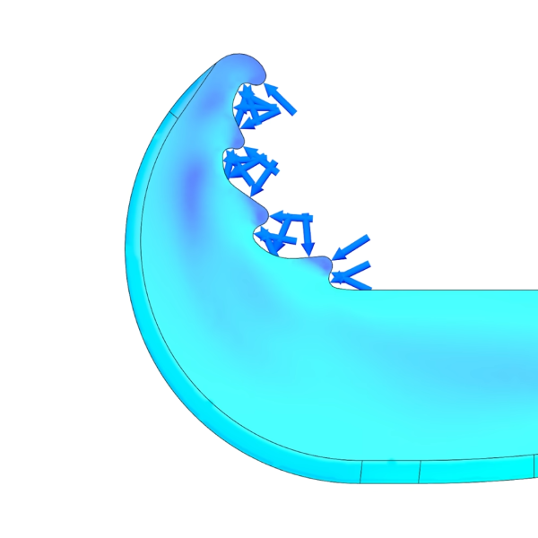

There’s never been such a thing as being “too competitive” when it comes to competition. This is something that [Tom Stanton] from “Tim Station”, [Tom]’s 2nd channel, took to heart for Polymaker’s 3D design challenge. The goal was simple: a single 3D printed part to hold as much weight as possible.
While seemingly simple, when considering the requirements, including a single print in addition to being able to open up for the mounts, the challenge gets exponentially more complicated. While the simplest and strongest joint would be a simple oval for uniform stress, this isn’t possible when considering the opening requirements. This creates a need for slightly more creativity.
[Tom] starts out with two flat C-shaped geometries to test his design. The design includes teeth specially placed to allow the forces to increase their own strength as force is applied. Flat features have the unfortunate quality of being able to slide across each other rather easily, which was the case during testing; however, the actual structures held up rather well. Moving onto the final design, including a hollow cavity and a much thicker depth, showed good promise early on in the competition, leading up to the finals. In fact, the design won out over anything else, getting over double the max strength of the runner up. Over an entire metric ton, the piece of plastic proved its abilities far past anything us here at Hackaday would expect from a small piece of PLA.

      ” I have not found any asymptote or lower limit for the stress, below which creep does not occur. Even if the sample survives initial loading, the sample can snap anyway. I loaded a sample to 57.5 MPa, it creeped for about 25 seconds, and then it snapped.”
      40-50 MPa is a pretty typical limit for common thermoplastics where you can expect an “instant” creep failure. If you do a finite element analysis in your preferred CAD suite, reaching this level of stress means your design will fail. 4-5 MPa means it’ll last a good while – practically forever – that’s a good rule of thumb design goal.
      What that means, a 10×10 mm sample (100 mm^2) will hold 5 MPa x 100 mm^2 = 500 Newtons or 51 kilograms OR about 510 kg for a few seconds. Reaching a ton is pretty easy, but, you would not want to suspend yourself from it since the static stress limit is just 102 kg and that’s too close for comfort. Swing around a little and the plastic starts to give up.
      Just in case anyone starts thinking they can design 3D printed climbing shackles.
