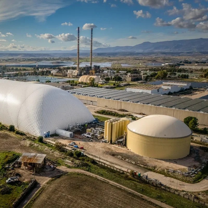

The big white thing is is the CO2 exhaust bag.

    1. This is the lie of renewable energy.
      Besides at room temp. liquid CO2 rests at 300PSI.
      That must be some bag they are holding that CO2 in.
      Re-thinking the Space Elevator again I see…..
      1. The bag is for the non-compressed CO2.
        The small yellow cylinders next to it are for the liquid CO2, and the domed building next to that is the generator and compressor hall.
        1. the domed building has an indentation in the dome that kind of makes it look like a butt at certain angles. as if the installation is telling us to bend over and take it.

      However I’m kinda nervous about a huge storage of a heavier-than-air suffocating gas… that seems like an industrial disaster in the making. And would be very vulnerable to can’t-prove-it’s-Russian attacks.
      1. I was thinking the same thing; I wouldn’t want to live near it, if that giant balloon fails, there is going to be a ground-hugging cloud of deadly gas. It doesn’t even need to replace the oxygen all that much, a high concentration of CO2 is deadly even when there is sufficient oxygen left
        1. Indeed, but how near do you have to be for it to actually be a problem?
          Worst case big catastrophic failure with no wind to disperse and mix the gas rapidly the area of threat to life might be large eventually but the danger pretty low for most of it – its going to take a fairly long time for the gas to get out to that radius folks can be evacuated I’d think. But I suppose such rapid deflation with geography and wind direction that wants to rapidly spread and funnel it could be a problem for a large area quite quickly.
          Either way though no way something like this should exist in the UK – land is just too valuable a commodity for such consumed like this. When much more power dense options exist, even if they cost a bit more to build its going to be worth it.
        2. co2 hugs the ground and can flow like a river into lower areas. i think there was some issue with some co2 lines here in the states that was causing all kinds of mayhem. lets hope you didnt build your home in a low spot.

            Also this big gas bladder doesn’t last forever either, probably from the article at least a shorter lifespan than the solar would have, but that is rather beside the point, as nothing lasts forever. The big point no matter what you are doing is land area is finite, and by far the limiting factor in many places so anything that consumes so much of it to be a really low energy density and probably really inefficient battery just doesn’t work out well – Cover the same area with Solar and a tiny battery and the batteries will need replacement once maybe twice in the lifespan the bladder expects but they have likely cycled vastly more useful power through them as the efficiency is good, and the solar cells are still 80% of brand new and almost certainly better (seriously modern panels if they don’t get physically damaged are getting towards 20+ years in the 90-95% of new sort of range – age is so often less impactful than how recently they were cleaned and the weather!). And for good measure its not just an energy store its actually generating it.

          3. than this giant bladder
            I think you over-estimate how giant the bladder is: 12.3 acres is just 0.0497 square kilometers.
            That’s for ~200 MWh of storage capacity. If we scale that up to roughly 1 Terawatt-hours, which is about 1/600th of the yearly electricity consumption of Germany, it would only occupy less than 16×16 kilometers of land.
            In other words, if you build kilometer by kilometer farms of gas bladders, and repeated that 250 times, you could get enough grid storage capacity for 14-15 hours of average demand on the German grid. That shouldn’t be too difficult, or costly. That’s just perfect for overnight backup of renewable energy.
            The same amount in lithium-ion batteries would cost around $150 billion. That may not sound like too much, until you consider that it needs replacement every 15 years regardless of use, while a gas bladder at atmospheric pressure is basically just a big plastic tarp with a relative cost of nothing.
