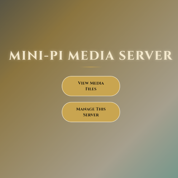

Part of the reason this server uses such low power, coming in just around two watts, is that it’s based on the Pi Zero 2W. It’s running a piece of software called Mini-Pi Media Server which turns the Pi into a DLNA server capable of streaming media over the network, in this case WiFi. Samba is used to share files and Cockpit is onboard for easy web administration. In testing, the server was capable of streaming video to four different wireless devices simultaneously, all while plugged in to a small USB power supply.

    1. Thanks for the tip on Aroz OS.
      Some of that functionality is already covered by logging into cockpit (from the main web page ‘manage server’) and selecting the file navigator. users can upload and download files, move files or delete files
