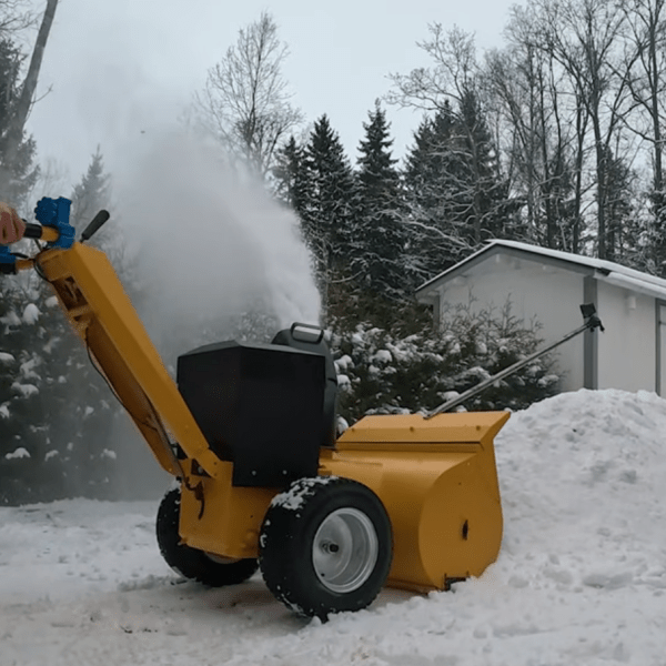

If you live in snow country and own a home, you either have a snowblower or wish you did. The alternatives are either an expensive and potentially unreliable plow service, or back-breaking (and heart-attack inducing) shoveling. [RCLifeOn] was one of those people in the second category, until he decided to do something about it: electrifying a scrap snowblower with a blown engine.
The usual brushless DC motors and electronic speed controllers [RCLifeOn] has on hand to get his R/C life on with don’t quite have enough oomph to handle both functions of a snowblower. For those of you cursed to live in warmer climes, the modern snowblower is both self-propelled via its twin wheels, and generally has a two-stage powered snow-removal “blower” consisting of an auger to break up the snow and an impeller to blast it out of the machine and many meters off the driveway. On the traditional gas-powered models, these are both powered via belts off the same motor, but that wasn’t going to work.
He kept the belts, and simply used a pair of motors, each with their own ESCs that are controlled via oversized thumb wheels on the handles. The belts couple to the motors with 3D printed pulleys. Belt tension is achieved in the case of the wheels through a simple and sensible shimming arrangement. In the case of the blower motor, he uses a 3D printed adjustable mount to get the appropriate tension. To help it hold long-term (given the issues with creep in 3D prints) he’s got a bearing on a second mount opposite the motor.  It holds up for his demo, which consists of clearing a driveway of 10cm of snow and then plowing through a pile larger than the mouth of the machine. In other words: it works.

  2. The dead-man switch won’t save your fingers when the auger picks up a stick and gets jammed – if you reach in to pull out the stick, it can release the tension and you ain’t fast enough to get your hand out of the way, Frodo.
    1. I don’t think you are understanding the point of the Deadman switch. On modern snowblowers, as soon as your hands are off the handles the auger has no power to it. Nothing is trying to turn the auger.

    2. Usually the “drive” connection between the auger and the driveshaft for it, is some dowels or bolts made of soft material that’d shear in half in such scenario.
      Though not uncommon to see it being replaced by hardware store bolt & nut.
  3. Having never used a snowblower before, despite living in Michigan for years, I question the necessity of having it self-propelled. Sure, if you’ve got the power handy then why not? But, if you are having to add an additional motor just for that, then why can’t you just push it along? It’s still a lot less heart attack inducing than shoveling.
    I’ve used plenty of gas and electric lawn mowers that were human propelled as well as self-propelled and the difference wasn’t really all that much.
    1. Two things worth considering are: 1) Snowblowers tend to weigh more than even the heaviest gas or electric lawn mowers, and 2) Unlike a lawnmower which moves over a lawn to cut the grass blades, a snowblower will encounter more resistance when moving forward since in needs to gather the snow into the auger blades for it to be propelled out of the chute.
