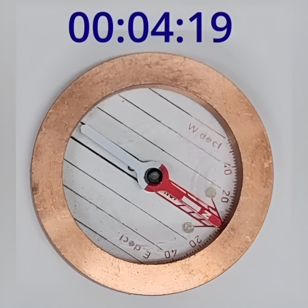

At some point during our primary school careers, most of us probably constructed a simple compass, often by floating a magnetized needle on a cork in a cup of water. The water in such a configuration not only lets the needle spin without friction, but also dampens out (so to speak) the needle’s tendency to swing back and forth across the north-south line. Liquid-filled compasses use the same principle, but even well-made compasses can develop bubbles when exposed to temperature or pressure variations. Rather than accept this unsightly state of affairs, [The Map Reading Company] designed a new kind of liquid-free, inductively-damped compass.
It’s hard to design a compass that settles quickly, even if it uses a strong magnet, because the Earth’s own magnetic field is just so weak, and the stronger the internal magnet is, the more likely it is to be thrown off by nearby magnetic objects. As a result, they tend to swing, overshoot, and oscillate around their final orientation for some time. Most compasses use liquid to damp this, but a few, mostly military compasses, use a conductive baseplate instead: as the magnet moves, it induces eddy currents in the baseplate, which create a weak magnetic field opposing its motion, slowing the magnet down. Inductively-damped compasses don’t get bubbles, but they don’t let you see a map through the baseplate. [The Map Reading Company] dealt with this by making the baseplate transparent and surrounding the compass needle with a ring of high-conductivity copper alloy. This gave him a clear baseplate compass for easy map reading which would never develop bubbles. It’s a simple hack, and should be easy to replicate, but it still seems to be a new design. In fact, [The Map Reading Company] is releasing most of the design to the public domain. Anyone can build this design.

  4. Is this not just the design of a Brunton Pocket Transit? That one has a aluminium damping ring. The difference maybe that he now included a transparent bottom.
    1. I did some further digging, but although the one of my grandfather from memory had a flimsy bottom and a big aluminium outer ring I could not find online that the ring is the functional part or that it also relies on the bottom being solid.

  6. At first glance, this “can’t work” — the net flux through the single turn of copper is not changing.
    But that’s the key: it’s NOT a single turn of wire. The magnetic field at the tips of the needle are interacting with a local bit of copper in its immediate proximity. Since that interaction is governed by a very strong inverse-power law (at least inverse-cube, probably much more) the tip of the needle must be very close to the conductor to work.
    The specificity of the copper alloy is a bit of snake oil though.
    And aluminum has got better conductivity per unit weight anyway.

  7. Leaving aside whether this is actually a new compass idea, the video demonstrating it is very sketchy. At the exact moment the novel compass slows down massively in the video around 12;19, there is a complete shift in lighting between timestamp 00:00:19 and 00:00:20, indicating that there are two videos that were sliced together. Youtube Comments that indicate this including mine have been removed entirely.
