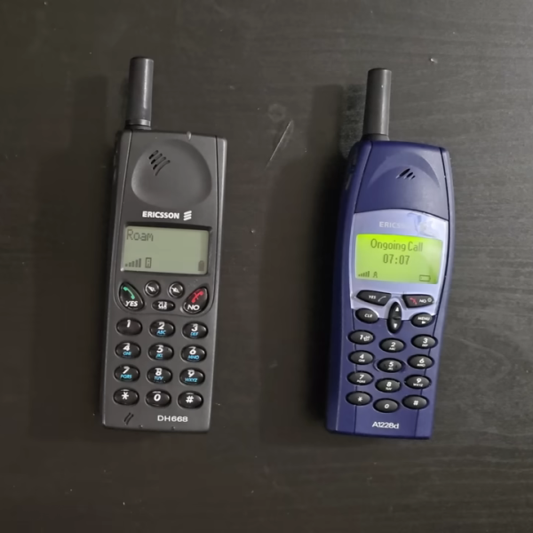

Modern cellular networks are built to serve millions upon millions of users, all while maintaining strict encryption across all communications. But earlier cellular networks were by no means so secure, as [Nostalgia for Simplicity] demonstrates in a recent video.
The video begins with an anecdote — our narrator remembers a family member who could listen in on other’s conversations on the analog AMPS phone network. This was easily achieved simply by entering a code that would put an Ericsson handset into a test mode, in which it could be switched to tune in any desired AMPS channel. Since the communications were transmitted in a purely analog manner, with no encryption of any sort, any conversation on such a network was basically entirely open for anyone to hear. The video shows a recreation of this method, using a software-defined radio to spin up a low-power, very local AMPS network. A phone call is carried out between two handsets, with a third handset able to listen in just by using the special test mode.

  2. I had that exact Ericsson 1228d in blue shown in the header in high school and yes, it was that easy, whenever I got bored i just tuned into other people’s conversations. As you had to try a different channel each time and each part of the conversation was on a different channel the eavesdropping was one way only.

  12. Isn’t the Nokia phone on the left a GSM (2G) phone? I have one (but not in blue) and it takes a SIM card. Unless they reused the case from an earlier analogue model.
