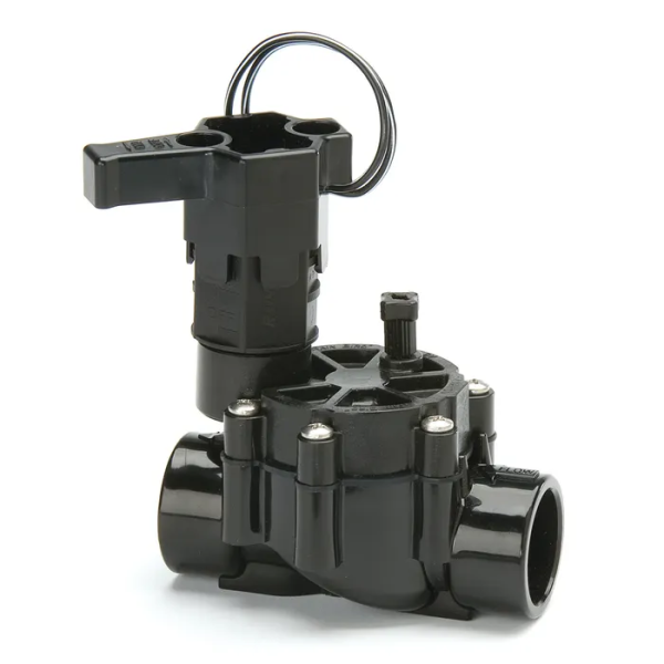

Due to historical engineering decisions made many decades ago, a great many irrigation systems rely on solenoid valves that operate on 24 volts AC. This can be inconvenient if you’re trying to integrate those valves with a modern smart home control system. [Johan] had read that there were ways to convert these valves to more convenient DC operation, and dived into the task himself.
As [Johan] found, simply wiring these valves up to DC voltage doesn’t go well. You tend to have to lower the voltage to avoid overheating, since the inductance effect used to limit the AC current doesn’t work at DC. However, even at as low as 12 volts, you might still overheat the solenoids, or you might not have enough current to activate the solenoid properly.
The workaround involves wiring up a current limiting resistor with a large capacitor in parallel. When firing 12 volts down the line to a solenoid valve, the resistor acts as a current limiter, while the parallel cap is initially a short circuit. This allows a high current initially, that slowly tails off to the limited value as the capacitor reaches full charge. This ensures the solenoid valve switches hard as required, but keeps the current level lower over the long term to avoid overheating. According to [Johan], this allows running 24V AC solenoid valves with a 12V DC supply and some simple off-the-shelf relay boards.

  9. The DC-powered OpenSprinkler takes a different approach to this problem: it uses an internal boost converter to generate a high impulse voltage to provide inrush current, then lowers to the input voltage to provide holding current:
    https://opensprinkler.com/introducing-dc-powered-opensprinkler-v3-4/
    The latest version (v3.4) leverages USB-C PPS to negotiates an optimal holding voltage to match the valve’s specific coil resistance and holding current requirements. Apparently the solenoid coil resistance can vary quite widely (as low as 20 ohm and as high as 60 ohm). So fine-tuning the holding voltage can be important to ensure the solenoid remain reliably activated while minimizing power consumption.

  11. It’s not really a tech-heavy solution, but you could just buy DC sprinkler valves. Any decent supply house selling AC sprinkler valves should also have DC ones. Rainbird, K-rain, Hunter (all the bigger US brands) make DC versions and they’re the same cost as the AC ones.
  12. Could you provide some links? The only Rainbird and Hunter valves I can find (which are DC rated) are latching valves – they are very different and would require H-bridges to operate. Many motorized ball valves (e.g. by U.S. Solid) do work with both AC and DC but they are usually much pricier.
