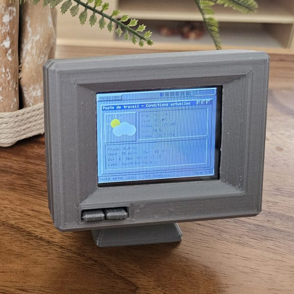

Sometimes you really need to know what the weather is doing, but you don’t want to look at your phone. For times like those, this neat weather display from [Jordan] might come in handy with its throwback retro vibe.
The build is based around the ESP32-2432S028—also known as the CYD, or Cheap Yellow Display, for the integrated 320 x 240 LCD screen. [Jordan] took this all-in-one device and wrapped it in an attractive 3D-printed housing in the shape of an old-school CRT monitor, just… teenier. A special lever mechanism was built in to the enclosure to allow front panel controls to activate the tactile buttons on the CYD board. The ESP32 is programmed to check Open-Meteo feeds for forecasts and current weather data, while also querying a webcam feed and satellite and radar JPEGs from available weather services. These are then displayed on screen in a way that largely resembles the Windows 95 UI design language, with pages for current conditions, future forecasts, wind speeds, and the like.

  1. >attractive
    >3D-printed
    There are also people who will find 350+ pounds hairy grannies attractive. Doesn’t mean that’s sexy for the general population.
    1. Yeah I really uh
      so like you -can- get good looking prints but for some reaaon so many 3d printing… “enthusiasts” really suck at it like this guy. Gheez. It’s rough
    1. This is sorta-close to how Windows 95 looked like. Windows 3.1 used comparatively tall title bars with two flat buttons on the right. Windows 95 had a narrow title bar with a cluster of three raised buttons. Then, Windows XP went with bubble-style, rounded title bars.
      The reason it looks off is that it’s using the wrong typeface and the edges of raised / sunken elements are rendered wrong (https://hackaday.io/project/205193/gallery#4d6d178b0ba08b4756fcef3cb45e4826).
      1. It looks like a Win16 application (say winhelp.exe) or text-mode application (say command.com) on XP i586 (if running a visual style).
        Because that’s when the deformed classic window decoration appears on real Windows.

  3. The CYD has a vertical ‘phone’ display, by mounting it horizontal the display quality is really bad on most viewing angles. Since even the original demo on the boards gets this wrong and almost no one used vertical CRTs back in the days let’s just pretend it adds to the retro charm.
