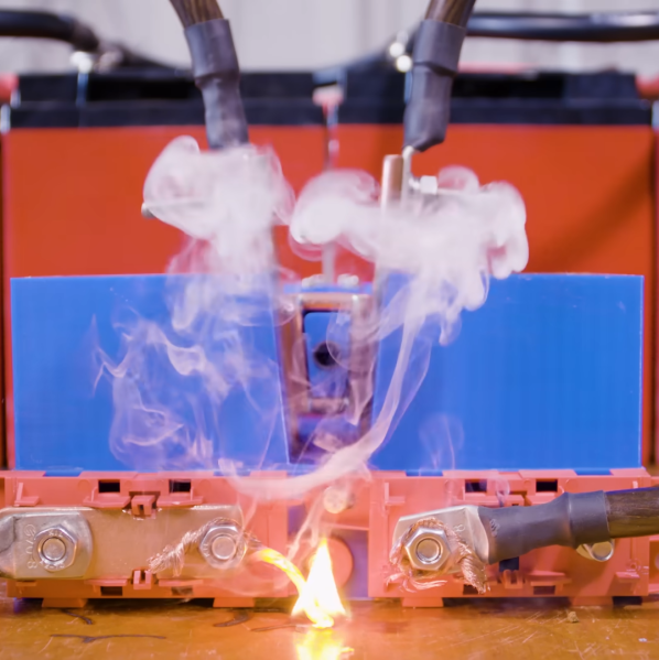

A switch is simple: connect two pieces of metal together and bam! Except, it’s not that simple at high currents. How much current? Just about 400 car batteries worth would certainly cause some issues. This is the issue that [Technology Hobby] hoped to fix with his clever switch design.
While many content creators are great at finding or making high-current sources (looking at you, Styropyro), their switches can’t always hold up to the abuse. [Technology Hobby] found that many of the switches used by these creators had issues based on an inconsistent and limited contact area. Making a bigger contact patch is always fairly easy; keeping those contacts from skipping can be a bit more difficult.
[Technology Hobby] found success in making a V-shaped channel formed from separated contacts where a matching contact would bridge the gap between, completing the circuit. The construction of the high-current switch was simply done with a 3D printed frame filled with concrete for stiffness.

    1. The problem is the Rebounding from amperage on the switch. When the amps get high enough the switch will not make good contact, at first and will bounce until makes contact. This leeds to arching, hot spots and destroying the switch. This wedge, if done correctly can mitigate the bounce. This also has some downsides with the wedge welding to the contacts, and there is no good way to open the switch.
      This project was in response to StyroPyro’s 400 car batteries, which is a must watch. He used a hydraulic log splitter, and he still had really bad bounce when he was switch 160k amps, so he added another log splitter and then he had the issue of it being much slower, but it did help with bounce.

  2. Since the switch does not have melting parts fusing, should be as simple as lifting the wedge up again. Also voltage is low enough that there should be no arcing.
  3. StyoPyro himself commented some good things on the video. TLDR, he actually had considered a design like this but while it worked great at the currents tested here, StyoPyro was pretty sure it would have some significant drawbacks at the absolutely bonkers currents he was running.

  5. 400 car batteries. 160,000 amps? How would the switch not spot-weld itself shut? 12v may not arc much but those moments while it’s shutting or opening. Also what on earth are you people doing for hobbies my god.
  6. I would work on spring mechanisms to open and close the switch very rapidly and firmly. Reducing the time when the contacts are allowed to arc is very important. Also, what about submerging the whole assembly in some kind of dielectric fluid?
  7. That was StyroPyro’s exact response – he was pretty certain this design would definitely weld itself together at his scale.
