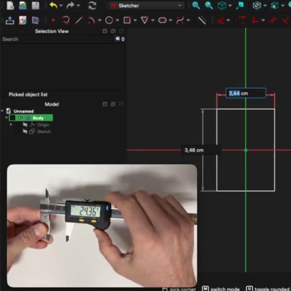

It’s a common ritual: whipping out those calipers or similar measuring devices to measure part of a physical object that we’re trying to transfer into a digital model in an application like FreeCAD. Wouldn’t it be nice if said measurements were to be transferred instantaneously into the model’s sketch, including appropriate units of measurement? That’s essentially what [stv0g] has done by merging a Sylvac Bluetooth-enabled caliper and FreeCAD using a plugin.
Key to the whole operation is a Bluetooth-enabled caliper like the Sylvac S_Cal EVO that [stv0g] managed to score on EBay for a mere €90 when it normally goes for multiple times that amount. This has BLE built in, using BLE’s standard GATT profiles for device communications specifications. Along with the provided Sylvac developer tools, this made it relatively easy to develop the InstrumentInput addon for FreeCAD.
This addon can be easily installed via FreeCAD’s addon manager as well, or if you wish to just use the calipers this way and don’t care about FreeCAD, the base Python library is also available.
Interestingly, this BLE-enabled caliper also supports HID mode, to emulate keyboard input, and thus it can work in any application by default. The reason why [stv0g] didn’t use this was that it only sends data when you press the caliper’s button, and it’s rather slow and limited.

        1. Based on how FreeCAD starts sketches now, I think this would be really useful if you have it set up to do a multi segment line. The workflow is well suited to an input mechanism like this. It’s not how I model things, but since FC1.0 there’s definitely a reason to rearrange my workflow and this would work quite well that way.

        1. The way FC1.0 works now is you draw a line, and it automatically pops up a window to ask you the length, and the way this seems to work is it auto populates that window. But at least with the way I have mine set up, you can type something into the window, and then retype it, and then retype it again or whatever, and until you hit another button it doesn’t actually get stored. So you could send the caliper dimensions, see that it says 3.498, and say oh well that actually needs to be 3.5, or just leave it and hit ok.
