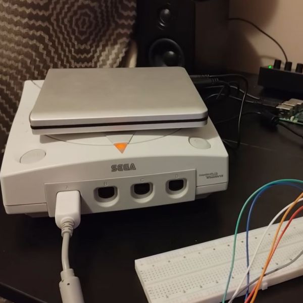

Although the Sega Dreamcast had many good qualities that made it beloved by the thousands of people who bought the console, one glaring omission was the lack of DVD video capabilities. Despite its optical drive being theoretically capable of such a feat, Sega had opted to use the GD-ROM disc format to not have to cough up DVD licensing fees, while the PlayStation 2 could play DVD movies. Fortunately it’s possible to hack DVD capability into the Dreamcast if you aren’t too fussy about the details, as [Throaty Mumbo] recently demonstrated.
For the Tl;dw folk among us, there’s a GitHub repository that contains the basic summary and all needed files. Suffice it to say that it is a bit of a kludge, but on the bright side it does not require one to modify the Dreamcast. Instead it uses a Pico 2 board that emulates a Sega DreamEye camera on the Dreamcast’s Maple bus via the controller port. The Dreamcast then requests image data as if from said camera.
On the DVD side of things there’s a Raspberry Pi 5 that connects to an external USB DVD drive and which encodes the video for transmission via USB to the Pico 2 board. Although somewhat sketchy, it totally serves to get DVDs playing on the Dreamcast. If only Sega had not skimped on those license fees, perhaps.

      AFAICT it only plays the video stream from a faked webcam…
      I mean it’s a hacky hack – no doubt about that but the title is a lie. Assuming the webcam doesn’t stream mpeg2(?) the Dreamcast isn’t even decoding the video from the DVD.

        I agree, I’d even say that it doesn’t “play” it but barely “renders” the stream. With the same logic, you can probably get a Tamagotchi to “play” a BluRay disc.
        So if you are wondering “can you really play a DVD in a DC”, as in put a DVD in the DC player and get it to play, then no.

          1. Little more “hack” than just pointing an OG DreamEye camera on any kind of thing that plays and displays a DVD’s content.
            So yeah, the part of “emulating” a DreamEye camera is a hack. The DVD playing part isn’t.
