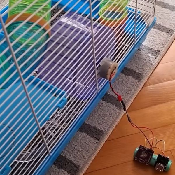

It seems fair to say that hamsters are a somewhat divisive pet, between their fluffiness, high-strung nature, short lifespan and incessant squeaking that sounds like some electronic device is trying to tell you something. With that in mind, maybe that having these fuzzy little critter take up some of the daily slack will help endear them to more people. Something like helping to charge mobile devices by converting their frantic exercise wheel time into electrical power. Cue [Flamethrower]’s hamster wheel-powered generator.
Due to the irregular pacing of the hamster on its wheel it makes sense to treat it as an energy harvesting problem, for which the common CJMCU-2557 module – featuring the TI BQ25770 – is a pretty good option. It covers a voltage input from 0.1 – 5.1 V after a cold start minimum of 0.6 V, with a maximum current of 0.1 A.
The modules come with a super capacitor to store collected energy, but you can further charge a connected battery, for which [Flamethrower] used salvaged 18650 Li-ion cells. After letting the hamster do its thing for a night in the – admittedly far too small wheel –  there’s enough power in the cell to at least start charging a smartphone, though sadly it’s not mentioned how much power was harvested.
Hopefully the hamster in question will be overclocked with a larger wheel, along with detailed measurements of how many hamsters it takes to charge the average phone.

  7. Am I the only one who is missing evidence that the battery was actually empty and got actually charged by the hamster enough to add any useful charge to the phone?
    If you account for all the losses, especially in the final step-up converter to supply the USB charging plug, I seriously doubt that the hamster contributed to any charging of the mobile handset.
    The charge probably originated from the (previously charged) battery cell.
    1. I never saw any measurements. I don’t think the motor turns fast enough to generate the 0.6V that the energy harvester requires to start. A small stepper motor would have made a better generator. They can produce quite a bit of voltage when turned by hand.
