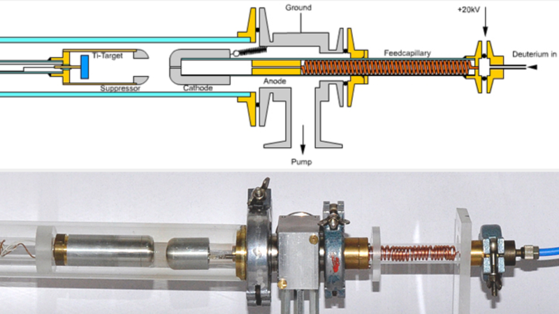

A diagram of a neutron generator is shown in the top portion of the image, with the physical version below.

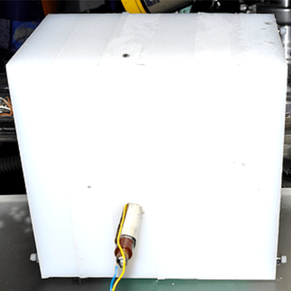

This particular generator takes a feedstock of pure deuterium, which it ionizes and accelerates into a titanium target. The first deuterium nuclei to hit the target react with it to form titanium deuteride, immobilizing them until more ions strike them and they undergo nuclear fusion. The fusion reaction mostly forms helium-4, but sometimes forms helium-3 and a free neutron, which is radiated away. The radiated neutrons are slowed down by a block of high-density polyethylene, and a portion of them strike a silver or indium foil wrapped around a Geiger counter tube. The neutrons activate the silver or indium, and the Geiger counter detects the resultant increase in radioactivity.
The design is a linear particle accelerator built inside an evacuated glass tube. It uses two high-voltage power supplies: a 20 kV supply which ionizes the deuterium gas fed into the tube, and a 100 kV supply which accelerates ions emitted from the source into the target. The target itself is surrounded by a cup-shaped electrode to capture secondary electrons emitted during impact. To prevent arcing, the tube needs to be at a very low pressure, reached by extensive use of an oil diffusion pump.
Radioactivity measurements of the silver and indium foils showed that the generator did work; when irradiating the silver foil for five minutes, it generated 175 counts per second after the neutron source was turned off. Plotting the count rate versus time suggested that a mixture of two silver isotopes was being generated, Ag-110 and Ag-108, based on their half-lives. Irradiation of indium produced a similar exponential decay in radiation.

  6. Would be great to have a bit more documentation/theory of operation on the design. Here are some questions I’ve come up with while looking into it:
    * Why is there this long feed capillary? What’s the advantage of feeding in the Deuterium via a long pipe like that, is this just for limiting the throughput? Also have you considered using a needle valve similar to what is typically used for DIY fusors, see for example https://fusor.eu/reactor.html#Gas_Needle_Valve
    * What vacuum level is required for the project? I’d assume the mean free path will need to be at least in the same order of magnitude as the travel distance of the Deutrium beam.
    * Do I understand it correctly that there is a significantly higher pressure before the cathode opening so that the 20 kV supply can generate a gas discharge (leading to ionization) there? And is the hole diameter specifically matched to keep this pressure difference while allowing some ions to get through?
    * Do you have an estimate of the Neutron output (and the associated danger level)?
    * Have you investigated the initial turn-on behavior? My assumption is that it will take a while to accumulate enough Deuterium atoms in the Titanium to have a real chance of hitting one, so it could take some time with the neutron output going up quadratically until it eventually saturates.
