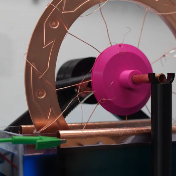

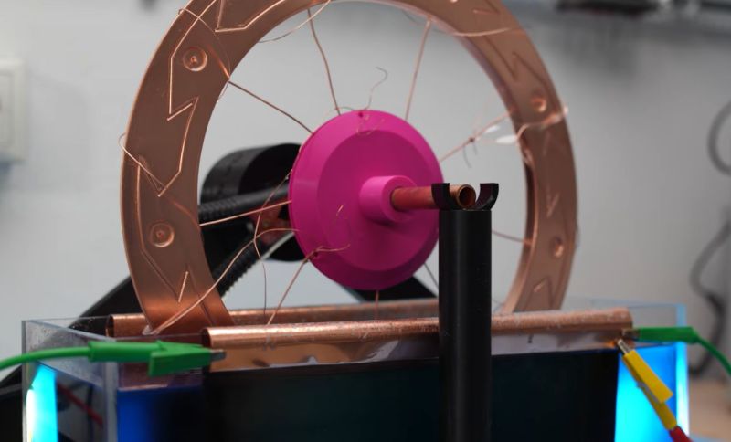

Electroplating 3D prints is a good way to get a pretty nice coating on even a basic PLA part, but generally you’re expected to dunk the entire part into a big vat with electrolyte after coating it with the requisite conductive paint layer. This is great for small parts, like a ring you’d put on a finger, but gets rather silly when it’s a much larger part, such as the one in [Hendrik]’s recent video. Out of curiosity he tried to see whether rotating the part through a much smaller vat would still get you an even coating, or not.
Perhaps ironically this process required building a custom vat out of acrylic, as well as an entire rig to hold up the part and gently rotate it. This highlights the main disadvantage of this approach, in that unless you’re doing a small production run or otherwise get to re-use the rig a lot it’s a lot of extra effort.
That said, the rotation is controlled by an ESP32 and a stepper motor along with a requisite stepper driver, with the most exotic part being the whole custom PCB and enclosure, all of which can be used repeatedly. With all of that tested and confirmed working, the part to be plated was sanded, sprayed with conductive paint and hooked up to the rotating rig for an overnight run.
Following that the part’s new copper coating was polished before more layers of electroplating were applied to get the desired two different colors from different metals. Along the way no issues were found with this method of rotating electroplating, so if you regularly struggle with oversized parts to electroplate, this would seem to be a viable method.

      You seem to have a limited understanding of the application and implication of this project. While this disc could have been plated in a shallow tray, this apparatus would be capable of plating a significantly larger and more complex object than a tray could, WHILE using much less electrolyte. Another factor you have not considered, Electroplating power supplies must be scaled to the surface area being plated. A shallow tray plating this entire part would require much higher current than this would.
      1. It is a bit… let’s say shortsighted rather than idiotic. As an experiment, it doesn’t prove much beyond its own special case.
        Consider that it works only for objects with a hollow center – otherwise you need to submerge the rotating axle in the liquid to cover all surfaces, and then you would get uneven coating between the center and the rim when one part spends more time in the liquid than the other.
        For the generic object, the tank needs to hold at least half the swept volume of the object, plus little bit more to account for the variable displacement of the object as it rotates, so you basically need a tank that contains nearly enough liquid to submerge the object anyways – especially if you allow for differently shaped tanks for different objects.

        2. Also, if the object wasn’t rotating you could save on the electrolyte simply by blocking off unneeded volume in the tank. Hot glue hollow plastic blocks, water bottles, etc. to the bottom of the tank.
          Then there’s also brush plating, where you basically apply the electrolyte with a soaked sponge connected to the electrode. In this video, a pump is constantly circulating the electrolyte, but at home you can get away simply dipping the sponge frequently or dripping the solution on it from a squirt bottle.
