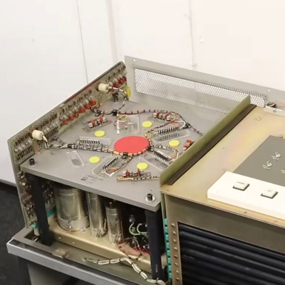

One of the nice things about magnetic storage is that as long as the magnetic layer remains intact, the data it contains should stay readable pretty much indefinitely. That raises the prospect of recovering data from really old computer systems featuring magnetic memory, such as the 63-year old LGP-21 that [David Lovett] of Usagi Electric is currently restoring. Its magnetic memory disk is nothing amazing by modern standards, but after initial testing it seems to spin up and read data just fine, raising the question of what was left on the drive when it was last used, meaning what was in memory at the time.
The read/write head side of the LGP-21's magnetic memory. (Credit: Usagi Electric, YouTube)
The read/write head side of the LGP-21’s magnetic memory. (Credit: Usagi Electric, YouTube)
Non-invasive data recovery here involves writing a program that will simply read the entire disk from beginning to end. Tracks 0 and 1 were found to be unreadable due to some kind of hardware issue, but track 2 could be backed up by looking at the output on the CRT, thus providing a track to use. Fascinatingly the LGP-21’s memory disks uses interleaved tracks to reduce the number of read/write heads as part of the overall cost-saving measures relative to the more expensive LGP-30. As you might expect, this slows down memory access a lot over its big brother.
Before any recovery attempt could begin, the Flexowriter typewriter that forms the user interface to the computer had to be given some serious maintenance, along with a few other components like a switch and the paper tape reader. This restored the ability to even properly enter data and receive output instructions.
The subsequent effort to recover the stored data involved a bootstrap program that got loaded into memory, after which the remainder of the program was loaded from paper tape. Following this everything worked swimmingly, though with the caveat that with not even a floppy drive to use, the raw hexadecimal data was hammered out on paper with the Flexowriter over the course of 1.5 hours.

    1. Something that many people who grew up with modern computers don’t know, is that some types of memory are inherently non-volatile. It used to be standard on computers with magnetic core memory, to have a way of shutting them down that preserves what was in memory, so they can be started back up without needing to be booted. And this was even more common on earlier main memory types, such as drum memory. On the LGP-21 in particular, you can write protect the first eight (IIRC) tracks so that even if your program crashes, it can still be restarted without having to go through a bootstrapping procedure.

  3. Track 0 & 1 are typically the landing zone for read/write heads, when the drive is spinning down or powering up. As the landing zone, it is most suseptible to data loss. On many drives those tracks are intentionally left blank.
      1. The track that holds the CPU registers (the program counter, the instruction register, and the accumulator) is not one of the numbered tracks – it is a track unto itself that is independent of the track addressing mechanism. Tracks 0 and 1 that he is referring to are the first two addressable tracks.
      2. The track that contains the CPU registers is even more special than that: all four registers (counter, instruction, accumulator, and extended accumulator (used for multiplication)) share the same track, and they each recirculate their own data, so that the contents of these registers are accessible at all times. Ever since David started describing this machine, I’ve been studying it, and it was quite an impressive example of innovation for cost reduction. Too bad all of this class of machines very quickly got replaced by machines using magnetic core memory.
        1. I learned to program on a Recomp II, which was derived (or maybe inspired by) from the LGP series. Design decisions were made on the basis of simplicity, not speed. Fitting a computer into a desk and selling it for a lower price than the big machines drove the design.
  4. Interleave was used on the LGP-21 to reduce average latency, because it ensured that most instructions completed before the next-numbered sector (and therefore the next instruction) came around to its heads. Kind of like why floppy disks and old hard drives used interleaved sectors. One thing to remember is that in terms of computer generations, this machine is difficult to compare with newer generations. Where most floppy and hard disks had sectors that held 256 or 512 bytes, each sector on the LGP-21 held 31 BITS, which was just enough for ONE instruction or ONE word of data.
