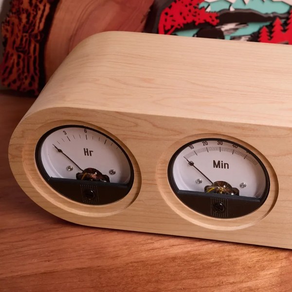

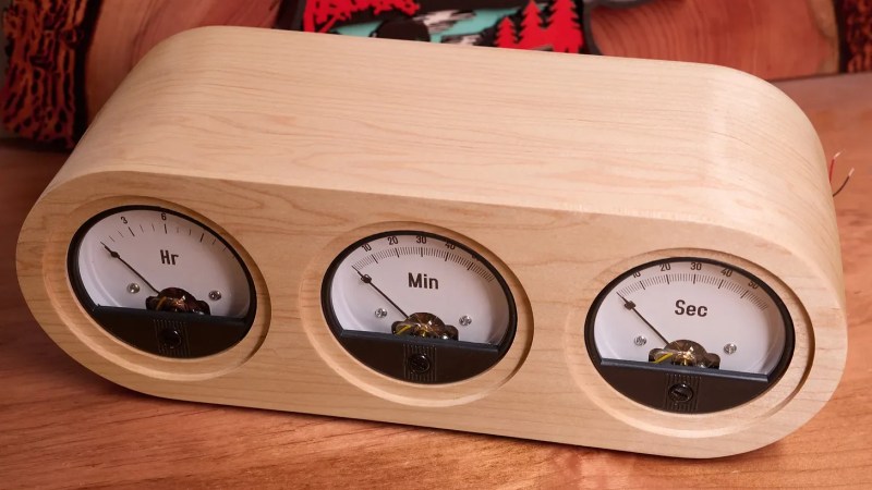

You could make a clock with three hands spinning about nested central shafts. If you did that, we probably wouldn’t publish it on Hackaday unless you really found a way to make it interesting. Make a clock out of voltmeters, however, and that usually catches our eye. [lcamtuf] has done just that.
The heart of the build is an AVR128DB28 microcontroller, an 8-bit microcontroller that is still currently in production. It runs at 8MHz, and drives a series of three Baomain 65C5 voltmeters to display hours, minutes, and seconds. Each has a custom printed face with the correct number of 13 or 61 divisions as needed. The voltmeters are driven by a continuous stream of 1-bit pulses with a software-controlled duty cycle determining exactly how far the needle moves. Yes, it’s using simple pulse width modulation, coded by hand by [lcamtuf] to do the job. All the components are wrapped up in a beautiful wooden case, with delicately kerf-bent panels to create the attractive curved lines.

  1. Very nice, both on the technical and craftmanship. There is just one thing with these clocks, I like a smooth rising and falling so I find the “reset” jarring. What would be really cool is to have the clock faces made with epaper and when the arrow reaches one end the clock face itself changes and then the arrow slowly goes back to the other end, if you understand what I mean. I’m too stupid to build one myself but it would be cool to see.
    1. “… I like a smooth rising and falling so I find the “reset” jarring…”
      I think this is a very pretty clock.
      I agree with your remarks about reset… I was a rather surprised at the relative violence with which the needles drop.
      These are probably inexpensive movements with little damping.
      On the plus side I think the issue could be easily mitigated with a small capacitor across the terminals of each meter movement.

  2. re: “the correct number of 13 or 61 divisions”
    At first glance this makes sense inasmuch as you need (n+1) lines to delineate (n) spaces, but it also means that this clock counts time from 0:00 to 11:59 (as you can quite clearly see in the video or article).
    I mean, it’s still dead simple to interpret and perhaps more logical than the way a traditional clock face works, but surely I’m not the only one that thinks it’s weird for a 12-hour clock would have a zero hour instead of a twelve?
    1. (and yes, admittedly you could “fix” this just by labeling the beginning of the hour scale as “12” instead of “00”, like a traditional clock, if you really want to confuse everyone)

    1. [Author here] For $9 a piece, I expected the renowned Baomain corporation to do better. But seriously, I think that the dramatic drop makes the clock more fun. When I built the first version back in 2019, I spent a while wondering if I should compensate in software, but decided resoundingly against it.
    2. Assuming those are normal d’Arsonval meter movements, the damping would be up to the driving circuit. If the driver had lower output impedance they wouldn’t bounce so much. And you’re right. Definitely heathens.
      1. Re: driver impedance: Righto. The PWM driver presents an open circuit when it commands the meter to zero.
        Simply placing a single resistor in parallel with the meter coil will damp it. The value of the resistor to achieve critical damping depends entirely on the meter characteristics, and might be lower than the driver can tolerate.
        1. Ach. Sorry: correction. The AVR drives high and low, so not open circuit, doesn’t behave as described here. This meter might not be able to be damped with just a resistor.
