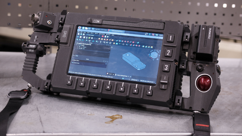

[Jankbu] needed a new computer, but had little interest in purchasing a modern laptop off the shelf. Instead, it was time to build a cyberdeck with a neat modular design to suit his exact needs.

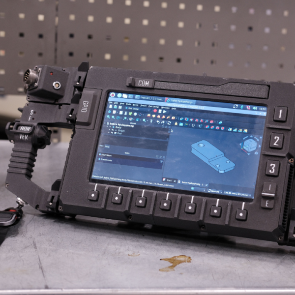

The heart of the build is a Raspberry Pi 5, which provides a good amount of computing power for regular tasks. It’s wrapped up in a 3D-printed enclosure with rail mounts on the back, along with a NOS 450 TKL mechanical keyboard, offering full-travel keys in a compact layout. The 10.1″ IPS touchscreen display is mounted on sliding rails to cover the keyboard when it’s not needed. A smattering of buttons live around the screen, in a manner akin to so many industrial controllers. On either side, the deck has large grab handles, with one side featuring custom horizontal and vertical scroll controls, while the other rocks a trackball.  Power is via NP-F batteries, which are more commonly used to run Sony camcorders.
Unlike so many cyberdecks, [Jankbu] didn’t just build the device to look cool—it also serves a practical purpose. It’s great for running Freecad, and the rail mounts on the rear make it perfect for mounting around the workshop during a job as needed. Files are on Github for those eager to learn more.
What’s fun about this build is that it’s not just a show piece, it’s something that gets used every day. That’s a testament to [Jankbu’s] well-reasoned design, that considered what the device was for before it was put together. We’ve featured plenty of other fantastic cyberdecks in the past, too. Video after the break.

      1. Did you watch the video? He didn’t build it to use at the bus stop. He built it for his machine shop. Look at how it just clips onto his mill and he uses it to view the design of what he is working on.
        He might just be talking it up for the video.. but it looks pretty convincing that for him, this form is very functional.

    1. Not sure you could fit a framework in something like this without really sacrificing on just about everything else the design is for, though I too hope to see more framework based builds. Yes Pi 5’s are not really cheap for the performance, but they are very performant for their tiny footprint and thermal demands, which in this case probably matters a great deal more. Also able to run off that camera battery, something I don’t know you’d be able to get a framework to do without hobbling its performance significantly.
      Maybe that new Apple Neo thing would make a better choice, but again that would be very very expensive, has rather less IO and far as I know still locked to the Apple ecosystem. Or a Steamdeck motherboard perhaps, as again rather small, relatively low power draw for the performance so the cooling wouldn’t need to be too crazy, though again expensive..
