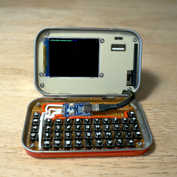

A Cyberdeck That Runs Linux…in An Altoids Tin
In the time Hackaday has been in existence we must have brought you plenty of projects housed in Altoids tins, as well as a sizeable number of cyberdecks. But until today with [Exercising Ingenuity]’s build, we’ve never brought you a project that combines the two. It’s a fully functional computer that runs Linux, and with its Altoids tin enclosure, looks for all the world like a miniature clamshell laptop.
Hardware wise it’s a Pi Zero with a UPS PHAT and an SPI display, but perhaps it’s arguably the home-made keyboard that really sets it apart. There’s a full-size USB port as well, and a selection of GPIOs are broken out to a header. It wasn’t all plain sailing though, the Altoids hinges needed modifying to make it close, and he driver for the SPI screen required an older version of Raspberry Pi OS. We will forgive it those foibles.
It’s fair to say we’ve not seen anything quite like this, in that there have been plenty of tiny laptops but never one as integrated as this. There’s a demo video with details of the build, that we’ve placed below.

    1. No company would ever touch a cli linux computer if they expected to make a profit. Who would buy it? The Venn diagram of who would use it and who could build it at home is a single circle.
          1. This revision yes. But if they polished it a bit by maximizing the screen, adding a nice battery, maybe using a different SBC, and improving the keyboard I wouldn’t bother.
          2. So you fit in the circle. ;)
            Basically if they changed everything about it and made it a completely different thing that you probably could NOT build, you’d buy it. Got it. Thanks for pointlessly disagreeing while completely proving my point. lol
  2. raspberry pi in this form is always a failure because it’s fundamentally not a portable board. The pi zero has pretty low power consumption for an always-on linux box but fundamentally it doesn’t have any power save modes and that’s really the whole story.
    but wait! there’s more: “and the driver for the SPI screen required an older version of Raspberry Pi OS.”
    without knowing the details of this struggle, i’m just going to observe that this is a common struggle with raspberry pi. It’s not really open source and so to get drivers to work you have to target a specific version of the upstream firmware, which then before you know it that becomes a back version. Yuck. So many consequences of the low quality, low stability, and closed-ness of the underlying firmware.
    1. Somewhat ironically, the problem with the official waveshare spi display drivers – and many others – is that the PI has moved away from a display driver that handles everything by calling the VideoCore firmware/binary blob. The new setup is an open KMS rendering stack where everything is handled in kernel space, so the old proprietary drivers (based on Videocore’s DispManX library) no longer work.
      There are actually quite good open SPI display drivers for the new stack that work with many, if not all, of these displays, but they’re not configured or tested specifically for the waveshare implementations so they can be much harder to set up initially.. and the touchscreen aspect of the display is a separate driver to worry about, etc, etc.

  3. in my household, that would get confused for a regular altoids tin and thrown away.
    Cool build though! :)
  4. Nice! I love the concept, I been wanting a cyberdeck for a while now only a little bigger than a Altoids tin with about a 5 to 7 inch screen
