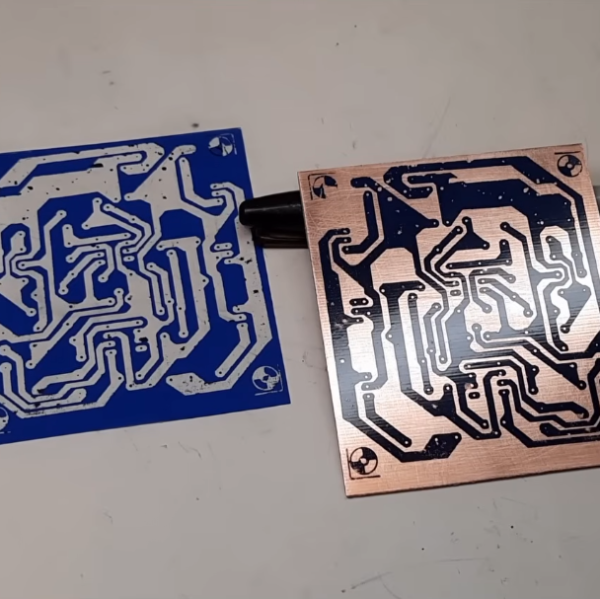

It’s never been easier to get a printed circuit board made. In fact, almost every electronics video out on the internet will incessantly remind you of this fact now. But making a custom PCB wasn’t always as straightforward as sending a KiCad file to a board house. Many DIY methods involve harsh chemicals and tedious processes, but did have the potential benefit of taking much less time than waiting on boards to arrive in the mail. [Bettina Neumryr] is demonstrating one of these older methods, called the toner transfer method, using a circuit that was printed directly in an old magazine.
The first part of the toner transfer method is to create an image that can be printed. Since this circuit came from a magazine, it is first scanned in to a computer and imported into GIMP, where it can be scaled to match the size of the components and then sharpened to make a crisp print. With the image ready, it’s time to print the image onto some toner transfer paper, ensuring that the printer in question is a laser printer which actually uses toner. From there, a sheet of blank copper PCB is prepared and then the toner is transferred by heating, in this case using a laminator. After that its etched, removing all of the copper not protected by the toner, and then the toner itself can be removed which leaves behind the copper traces.
For those of you who were around when toner transfer was in vogue, this video might not have much value. But for anyone who can’t use a board manufacturer for whatever reason or is looking for alternatives, a modern video showing the method could be much more useful and have better context for beginners than videos made a decade or more ago now. Some of those older methods include similar processes using inkjet printers instead, but there are more modern DIY methods as well using lasers or CNC machines too.

    1. Lessons learned from that time:
      Ferric Chloride while a great etchant is unnecessarily expensive and difficult to refresh after it has been used many times. Heat can help speed up well used etchant, but it is generally more trouble than its worth.
      Cupric Chloride solution made from hardware
      store HCl (muriatic acid) and Hydrogen Peroxide (first aid grade) works superbly well and can be driven in reverse with an aquarium pump to keep the etchant working well, again heat will always help.
      Presensitized copper clad generally gives the best results due to the uniformity and low thickness of the mask. Using a laser engraver to ablate the mask after leaving it to expose in the sun allowed me to reliably get 4mil tacks and 6mil spaces on single layer etches.
      Tin plating is a life saver. MG chemicals electroless tim plating solution while stinky is a dream to work with.
      Create a library footprint with a standard fiducial pattern that can be used to drill alignment pin holes to make registration between top and bottom masks easier. If you have a cnc with a high enough spindle speed to drive small drills those tooling holes are also useful for automating your drills. Drills with a diameter of 30mils on a 50mil to 100mil pitch are generally doable by hand with enough patience and proper annular ring aspect ratio.
      Clear coat spray from the hardware store works well enough as a single use mask if you have good fume extraction.
      Keep your package choices to SOIC and 0603 if possible. 0.8mm qfp and similar pitch qfn packages can be done with practice, but packages with thermal pads are almost always a no go unless you plan on making a stencil too. But since single sided layout is usually my first choice if I plan on etching a prototype, getting thermal pads to work well in the design is entirely dependent on the component pin out. Sometimes it will really help, but others it will be a nightmare.
      1. Photo gloss paper for toner transfer is also a great option. Overhead transparencies work really well too. Toner transfer with an iron or a cheap laminator from walmart works. Be careful with an iron as you can smear the toner ruining the fidelity of the transfer.
        Acetone to strip the toner.
        Cheap toothbrushes for cleaning and scrubbing.
        Use all polypropylene containers (look for PP marked in the recycling symbol)
        Do your research on proper neutralization and disposal procedures for whatever etchant you choose. I like to fish and swim, don’t be the reason people can’t enjoy the outdoors.
  8. I got to the stage of:
    Toner transfer to 0.8mm copper clad FR4 and etch once for the tracks and pads. A temperature adjusted laminator takes 0.8mm no problem and gives perfect repeatable transfers
    Toner transfer a second time on the copper side to mask the pads
    Airbrush with glass paint which can stand heat and chemical/solvent
    Strip toner masking with acetone
    Tin with tinning solution
    Do it all twice and glue them for a double sided 1.6mm standard board
    Dremel drill press and secondhand carbide bits from local fab houses
    Finally toner transfer a third time on the component side then spray with clear lacquer for silkscreen
    Ended up being able to make quite good boards – time efficient? Hell no. But part of the point was learning the process and going through the effort – now a $3 PCB from china is better and easier of course. I wonder if folks who grew up with easy pro PCB availability like there is nowadays lack the appreciation of what really goes into the PCB manufacture…..or is it just history repeating and I lack appreciation of something I’ve always had like cheap lightbulbs.
