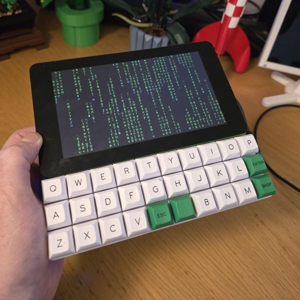

The cool thing about cyberdecks is that you get to design them to suit your personal tastes. [NickZero] wanted an ultra-minimal build, and set about putting together just that.
The build is based around a Raspberry Pi Zero 2W, which has a lighter power draw than the full-fat models at the trade-off of some processing power. Since it’s a W model, it has the benefit of wireless connectivity baked in from the factory. The Pi is paired with a Gherkin 30% layout keyboard kit, which neatly matches the 7″ Waveshare touch display in width. Power is courtesy of a juicy 4000 mAh lithium-ion cell, which is taken care of by an Adafruit Powerboost 1000 charger module. Everything is then laced up together inside a nifty 3D printed case.
It’s a simple cyberdeck, and one that’s probably quite satisfying to use when you get used to the fact that there are no number or modifier keys on the ultra-cut-down keyboard. It’s also a great example of how a bunch of off-the-shelf gear can nonetheless be assembled into quite a cohesive whole. In much the opposite way, we’ve seen some maximalist cyberdeck builds lately, too.

  4. I love the look of this, but I’ve used computers like this where the screen is flat with the keyboard and it’s always hard to use. If you use it flat, then the screen is very hard to read. You want to angle up the screen so you can see it more easily, so you have a kickstand for it, but then the keyboard is hard to use angled up so sharply.
    There isn’t a great solution except to have a hinge for the screen. But the screen is always heavier so it wants to flop backwards. So you have to weight the keyboard and now the whole thing is heavier and it’s less portable. The only solution is to make a super light screen and put the battery in the keyboard. And now you just have a laptop. It’s a hard form to get away from.
