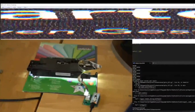

The talk covers all the work that [Yannick] did to make this a fully functional camera. That included doing a deep dive into Epson documentation to figure out how to interface the sensor at all. Thankfully, service manuals provided enough detail on how the 12-line RGB sensor works to get the project over the line. Interfacing the sensor was achieved via reusing the ADC and timing generation hardware from the scanner itself, hooked up to a Raspberry Pi 5 and a RP2350.
Plenty of work was required to figure out how to properly offset all the R, G, and B pixels to line up properly into a coherent color image. [Yannick] also dives into the mechanical design, regarding how the sensor was assembled on a 100-millimeter linear drive to scan it behind the lens assembly to capture images. There were also issues generating a live preview that you’d get on any other digital camera, which is not exactly practical to generate from a scanning image sensor. Instead, a standard Raspberry Pi camera was included in the build for live preview to help with lining up a shot.

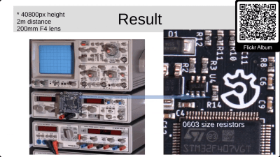

Perhaps the best part of the talk is when [Yannick] shows off the final results. The simple fact is that 3.2 gigapixel images capture a ton of detail when they’re taken well and focused correctly. A simple shot of some benchtop instruments doesn’t look like anything special, until [Yannick] shows that cropping in will let you read the codes off a 0603 SMD resistor. Obviously, the camera is limited when it comes to speed and it can’t really capture moving objects well. However, when it comes to grabbing very high resolution shots of still scenes, it’s a great performer. If taking gorgeously detailed landscapes or stunning architectural shots is your thing, you might find such a build an appealing proposition for your own needs.
