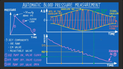

Many cheap electronic blood pressure monitors use the oscillometric method to measure blood pressure. Few manufacturers share the algorithms they use, but [Milos] has found many use something similar to the above, approximating systolic and diastolic pressures from measurements taken to find the mean arterial pressure. Credit: presentation slides
[Milos’s] talk focuses on the digital oscillometric analysis that is behind cheap electronic blood pressure monitors that commonly retail for $30-50. These devices start by pumping up an arm cuff to well above typical systolic pressures, before slowly letting it deflate. A sensor hooked up to the cuff is used to monitor the pressure during deflation. When the cuff is below systolic pressure but above diastolic pressure, the pressure in the cuff will oscillate with the pulsing of the blood flow. When isolated from the overall pressure loss from deflation, the amplitude of this oscillatory signal is maximum at the mean arterial pressure. According to [Milos], it’s common for electronic blood pressure monitors to then take some figure like 40% and 80% of the amplitude of the oscillation envelope, and grab the systolic and diastolic pressure values at those points. As far as accuracy goes, this method isn’t exactly perfect, being more of a useful approximation rather than something that’s rooted in a true direct measurement. Furthermore, [Milos] notes that, for example, Category A blood pressure monitors are only expected to land within a +/- 15 mmHg range, for 85% of their measurements. That’s not fantastic.

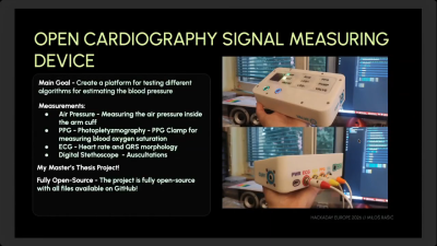

[Milos] has invested a great deal of time into the Open Cardiography Digital Measuring Device, hoping to better investigate alternative methods of measuring blood pressure in a non-invasive manner.

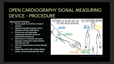

[Milos] notes that it’s important to allow the patient to sit still for five minutes before measurement if numbers are to be at all comparable between checks, as many factors can influence blood pressure in the moment.
