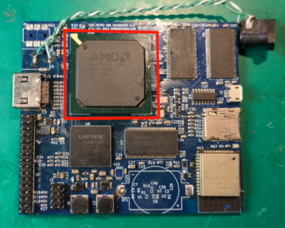

[Jeroen]’s first attempt had issues, mostly because it was difficult to properly solder the big BGA CPU package.
While [Jeroen] was looking to the past, he also wanted to take advantage of modern quality of life improvements, mainly by eliminating mechanical parts. Old hard drives and floppy drives from this era are seriously showing their age by now, and becoming particularly unreliable. There are better storage solutions available today that are faster and easier to use. The choice was also made to use modern peripherals, rather than relying on 30-year-old keyboards and mice.
The core of the build was an AMD Elan SC520, running at 133 MHz. This was one of the so-called “586” chips that were spawned following the 486 era, in [Jeroen’s] words, being a “486 but a bit souped up.” This chip came out in 2000, a full six years after Intel curtailed 486 production, a time when the Pentium III was already hitting 1 GHz clock speeds. It’s an anachronistic choice for a 1995 machine, but [Jeroen] picked it for good reason. The Elan SC520 was more of a system-on-chip, integrating lots of supporting low-level hardware onto the CPU itself, like the real-time clock and programmable interval timer (PIT), which would make his build easier. [Jeroen] threw this on a board with an FPGA and an ESP32 and a smattering of support components, and got a general purpose machine up together in a tiny form factor. If you’re thinking of a Raspberry Pi built with a knockoff 486, you’re not far off the money.

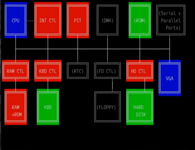

There was an early focus on just getting the basics up and running to get to a DOS prompt, before fleshing out the project and making it more feature complete. Credit: project slides
This first build had some issues that caused a lot of stress. Namely, the Elan SC520 was a large BGA, and it was difficult to verify if it was perfectly soldered or not. This meant that as [Jeroen] worked on the board and spun up the supporting FPGA and such, it was very difficult to know if things weren’t working because of his own code or because of a missing solder ball or a short. This led him to return to the drawing board.

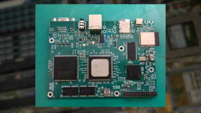

The second attempt had a cleaner design, using a classic CPU instead of a later-model system-on-chip. This proved far easier to solder.
The second attempt involved a regular CPU rather than the difficult-to-wrangle AMD system-on-chip. Namely, a classic i486 DX4-100 and AM486DX5-133 were sourced as potential CPU options. A C&T F65545 VGA chip was enlisted to handle graphical duties, being a laptop chipset that integrated lots of necessary support hardware into the one package. The plan was to throw just about everything else into an ECP5 LFE5UM-45 FPGA chipset, plus an ESP32-S3 to act as a peripheral interface. [Jeroen] decided to use SDRAM, which was much newer than that typically used with a 486, but this was chosen for being easy to integrate with the FPGA. With a goal to just get to a DOS prompt, [Jeroen] eliminated as much extraneous hardware as possible to get the project moving forward quickly. After spinning up a PCB, learning all about what it takes to bring up a 486-based machine, and working up the FPGA-based chipset, things all came together. A bit of cribbing from MiSTer projects helped, too. [Jeroen] eventually had his new old machine displaying a basic BIOS, then running some benchmarks, and then even running games like Commander Keen. The talk goes on to explain all the other little bits and pieces that come together, like storage, MIDI support, sound, and networking. Seeing it then turned into a portable game station named the Vapourdeck is just the icing on the cake.

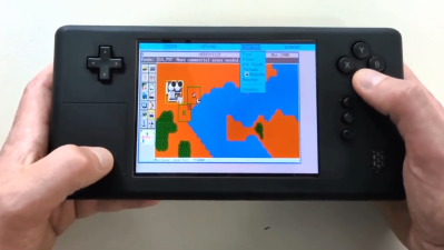

Further work saw the single-board machine integrated into a gaming handheld that [Jeroen] has nicknamed the Vapourdeck.

  1. “Namely, the Elan SC520 was a large BGA, and it was difficult to verify if it was perfectly soldered or not. This meant that as [Jeroen] worked on the board and spun up the supporting FPGA and such, it was very difficult to know if things weren’t working because of his own code or because of a missing solder ball or a short.”
    This is a solved problem: it’s literally what the JTAG boundary-scan test interface is for: you just literally toggle the pins via the JTAG interface and observe them either at test points or at the FPGA.
    The other trick, even without JTAG, is to solder the BGA first and use the protection diodes to tell if something’s connected. Then you can always reflow it again if there’s an issue.
    1. Sure, if something 100% did not make contact then JTAG or the protection diodes will show that. The issue I had is that the balls might be (barely) in contact with the pads, but not soldered to them. That means there is an intermittent connection, which is not easy to detect, but will absolutely drive you crazy if you think you’re solving some kind of timing issue.
      1. Yeah, I mean, I’m a bit lucky in that I’ve got a thermal chamber for easy stress testing on things like that – if it keeps contact over like -20 to +50 C it’s not a cold joint. Although one other trick I used to detect a poor joint in a remote situation is to heavily oversample the transition at the FPGA (like, literally as fast as the FPGA can possibly do it) – a poor joint actually shows pretty different edge transitions than a good one due to the capacitance.
        Now that I think about it it’s also somewhat harder because for older chips like this the voltages/etc. are so much higher just due to the process. Protection diode thresholds actually turn out to be really sensitive to cold joints on modern chips.
